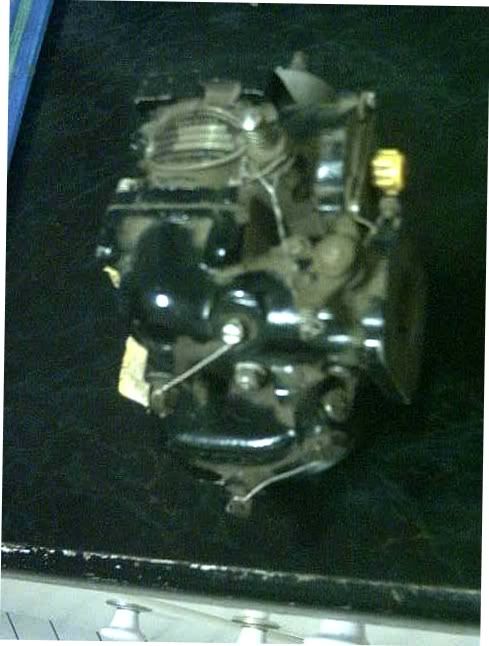

Hello other warbirds members. I have joined this forum in the hope someone can identify a stomberg carby for me and the types of aircraft engines it was fitted to. I have pics but would need to email them as I dont know how to post pics to this site. The details on the plate fixed to the side of the carby are stromberg carburetor model NA - HIE, SERIAL 5741263, PARTS LIST 392164G - 8, BENDIX AVIATION CORP there are still service tags and seals from 1959, but most of the writing is unreadable. I have used every search engine and combination i can think of, without success. Has anyone any ideas or information please. aplogies for pic quailty my camera is old. [img]http://i184.photobucket.com/albums/x83/bkm1508/CARBY/CARBY3%20IMG]http://i184.photobucket.com/albums/x83/bkm1508/CARBY/CARBY1B.jpg[/img] Image IMG]http://i184.photobucket.com/albums/x83/bkm1508/CARBY/CARBY2.jpg[/IMG] IMG]http://i184.photobucket.com/albums/x83/bkm1508/CARBY/CARBY1A.jpg[/IMG]

Bendix-Stromberg float carburetor. These fuel controls have a designated Model NA-XXX and range in size from the A-65 Continental engines up to the R-1340 Pratt & Whitney radial engines.
NA stands for "Natural Atomization."
NA - Natural Atomization
P - Pressure
Q - Small Pressure
Barrel Type
Barrel Size from 1-3/16" in 1/4" increments
Model Letter - Major modification signifying a model change
Model Number - Minor modification
Looks like it would likely be an H1E rather than an HIE.
Maybe not an aircraft application but for a tank?
