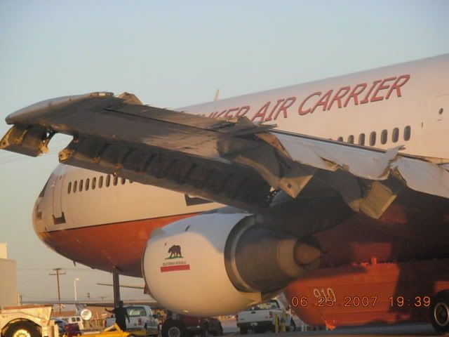

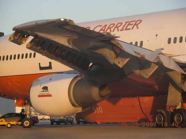

These pictures would surely seem to prove that. This will give you an idea
of how close this airplane came to crashing. Pretty unbelievable.

You'd be surprised at how well the DC-10 is built. From the photo's of the damage that I see, the major hits were taken up by one or two slats, and the inboard and outboard flap assemblies and the L/H aileron. Also, from what I can see of the #1 engine cowl, there is no immediately seen damage, unless it sucked up a branch or two and the first stage fan got mangled. The one thing I always hated about the DC-10, aside from it's riding like a CADILLAC, which it does and I used to love to fly on them, is the fact that they have way too much in cable driven items, where Boeing relies on Hydraulics. Meaning that all along the front spar and rear spars are all the cable clusters for actuator control. But, from what I can tell is mainly that the pilot(s) got too low for the terrain and clipped some trees. So, it is my opinion, having worked on DC-10's and mostly 747's that the damage looks worse than it is.
But....the powers that bee need to investigate......so I guess that they need to do their job to find out, as Paul Harvey would say..."The REST of the story".

I think these guys dodged a big bullet.
and
Finally some pictures...
Thanks.
