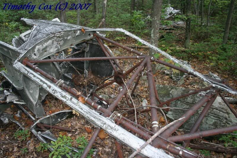

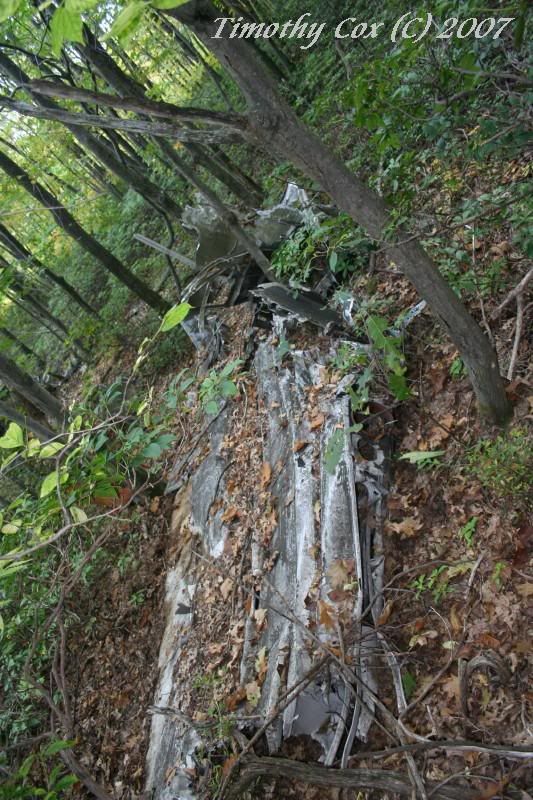

I visited a crash site of an AT-6 yesterday. I found out about it on line but it only referred to as some type of primitive WW2 trainer. After looking over some information on crashes in the area I figured it was AT-6D 42-85033 that crashed in mid 1945.

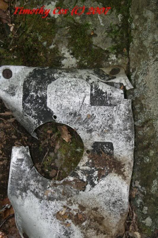

So I visited the site in hopes that it was a Texan, and that I might find some markings or ID plate to confirm my suspicion it is that aircraft. After looking at a few hundred pieces and climbing all around it I could only find one panel that looked like it had a "3" on it. (which might rule out anther AT-6C that might have crashed about 1 mile away as there are no 3s in that serial number).
So I ask... Are there ways of telling from the remains if this aircraft that it is an AT-6D or not? What might be good things to look for when I go check out Texan crashes as there seems to be several within a few hours of where I live now and I might get a chance to search for more. I'd like to order the crash report but that will not happen any time soon as I'm moving and I don't have the cash to do that right now.
Is this a case where the facts point to an ID and you just have to go with it? Is common in Wreck chasing?
Here are a few pict’s but I’ll do up a write for it soon as I have some time.

Well, from the looks of the main frame that WAS a T-6. And the area just aft of the rear seat looks just the same as the T-6D in our museum, but... that doesn't prove anything. :wink:

Here are my thoughts:
The swivel rear seat mount means it's not a "late model"
T-6 (not an F or G).
The original data plate was on the trim panel on the right side
of the front cockpit (if you were sitting in the front seat, it'd be by
your right shoulder). Can't tell from the pics you posted, but there
doesn't appear to be much left of the cockpit area...
If there was anything left of the electrical / charging system, you
might be able to infer whether it was a D or not by finding 12 volt
vs 24 volt components (24V = D model), but it doesn't look like
there is much left of the airplane....
