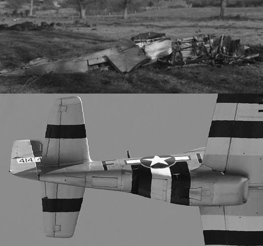

This first one is in England and the close up of the forward section of the wreckage may help. The stiffeners/ribbing across the flat sections of sheet metal may help someone ID it. I'm thinking a British aircraft but that's simply a guess.

First picture shows the rear end of a P-51, lying on her left side, with tail wheel doors partially open, and radiator door in front. Any chance to have a bigger scan, I would be interested?
You might be right for the second picture, it could be japanese.
Thanks for posting all those pictures.
Laurent

interesting pics, and I'd never had guessed P-51 for the first one; I hope the guy got out before that happened...

Thanks Laurent, like Greg, I would never have guessed a Mustang. Here's two close ups - I split it left/right since Photobucket will not send larger than 800x800.

Thanks for the close up. I had not noticed before that the bottom of the seat could be seen on the right side of the picture, still attached to the armor plate. No info on the picture such as date?

Maybe this picture will help you to figure it out, with some major parts missing....

Just to add to the topic of that being a Mustang in the crash photo...I went out to the Mustang that's about twenty feet from my office right now (CAF's Red Nose) and looked at the inside of the radiator door. It also has those rows of stamped sections on the door for strength. That is definitely a Mustang in the photo.
