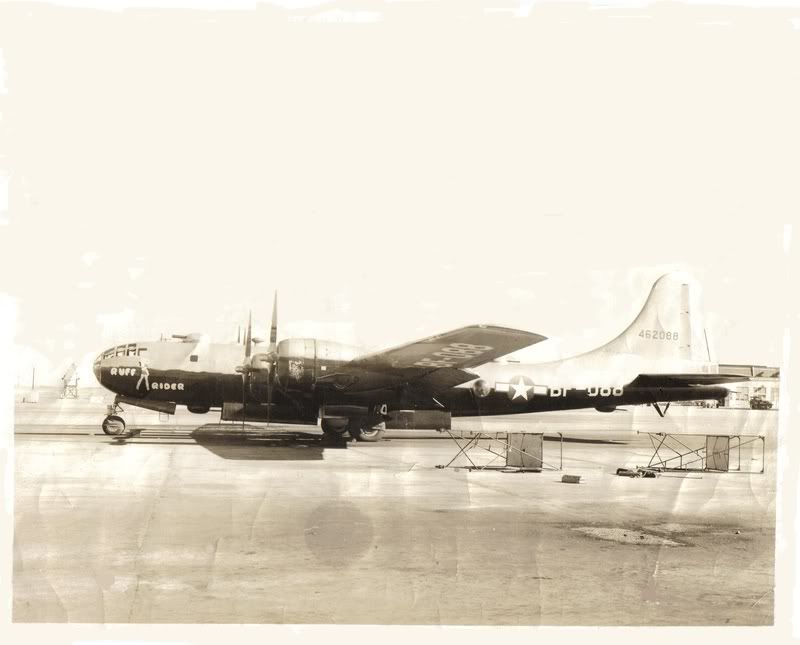

I was given this picture from my uncle some 20+ years ago, and thought it would be of interest to someone here.
Any comments are welcome, as I know very little about this picture, other than what is on the back.
Stamped letters saying "Offical Photo US Army Air Forces".
and then in my uncles hand writting "Smoky Hill Air Base Salina, Kansas 1947".
I cleaned the image up as best as I could, and I can post the original scan if needed.
Look closely behind the tail gun, and I think you can see what looks like a track driven tug, that's kinda interesting in itself.
After reading the post about "Doc", my mind was on B-29s, and this was the result.
I hope you enjoy it, and can share anything you may know about, "Ruff Rider"
Leon
Phormer Phantom Painter

Thanks, Leon!
That serial number is certainly close to another B-29 I'm somewhat familiar with! :wink:
Scott

FIFI is 44-62070, so these two could have shared apron space at Renton theoretically. Dig that paint job!
The photo your uncle took shows how the B-29 training fleet was equipped during the last few months of the war and on into peacetime. Notice how the propellers have aluminum painted cuffs--that was a wartime T.O. applied to 2AF training planes to assist with engine cooling, but I haven't seen any pictures of actual WWII combat '29s with the cuffs. (Except those with Curtiss props.) That black camouflage was discussed at length on another thread, and seems to have been depot applied to a fair number of later Renton airplanes. If you have any more pictures of your uncle's I would love to see them as I am working on a history of the Midwest AAF bases.
I am also putting out a request for ANY photos of 44-62070 that were taken from 1945 to the mid-fifties. We have been searching for pictures of FIFI in her original scheme for a while now.

PostPosted: Sun Jan 13, 2008 8:26 pm
Tug is probably an M2 Cletrac.
http://www.skylighters.org/encyclopedia/cletrac.html

I've seen pictures of a Cletrac moving A-26s at Pusan during the Korean War. They were 95 BS aircraft.
Admiral Isoruku Yamamoto

Yup, Ruff Rider has Hamilton Standards identical to what FIFI has today. There were two styles of blades, non-cuffed and the cuffed style seen in your photo. The combat airplanes in WWII all had non-cuffed (as far as I can tell from photos) and the cuffed design was a modification done on training airplanes here in the states. I have records from the Nebraska training field maintenance departments that refers to installing the cuffs per a Technical Order. I have not tracked down why none were sent overseas during WWII with the cuffed variety, but some flew combat in Korea with them installed. Here are a couple of photos to give you an idea of the two designs:
