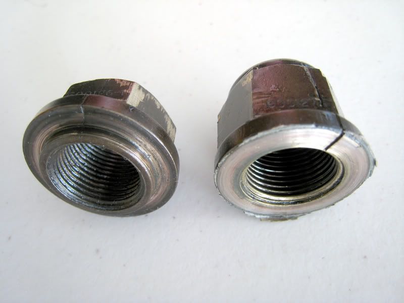

Cracked head nuts are fairly common on the Merlins but if you've never seen one, here are two we pulled off SUSU while we were doing the cams and heads yesterday. We had some oil spooges between the B bank and head so we kinda figured we might find one or two.

Good info. and pics. I haven't had the privilege of coming across one of those yet, but probably will...

I know very little about the Merlin. Where are these nuts located on the engine? Are replacement nuts easy to find? American standard, or British Whitworth thread?

They hold the head to the cylinder bank. BS thread form, I believe. They have to be re-torqued and the valve clearance checked every 25 hours.

BSF - British Standard Fine - at an educated guess. The same 55° thread angle as Whitworth but finer, strangely enough. :)
Whitworth, being coarser tended to be used more to get a decent bite into castings etc.

I got a bunch of the cracked ones sitting around as a paperweights.

PostPosted: Wed Feb 20, 2008 10:08 pm
Posts: 11335
Do the cracks always seem to start where a thread starts (or ends), or do they seem to crack in a random location?

The Snap-On BS sockets are 12 point rather than 6 pt. I have had a couple crack at a mark made by the socket. I now use a 6 pt socket. The torque on the nuts is in the neighborhood of 100 ft lbs so they do carry a load. I would say it is more of a random thing for location.

Good conversation goin on guys. I spoke with Big Jim, Jack Rouschs Merlin guy the other day and had a real good conversation with him. I'm more of a round engine guy so needless to say I asked a lot of questions and he took the time to answer them in a very cordial manner. That was much appreciated. I don't know if they tend to crack in a certain spot but on ours, if you look at the pictures closely, you'll notice that both are cracked through the flat where the part number is stamped. weird huh? The torque on the nuts is 115 ft lbs on the intermediates and 100 on the end nuts according to Jim. He also told me that they are trying steel nuts on the heads to alleviate the cracking problem but they do not have faa approval yet. I have Art Vances deal that he wrote up dealing with the day to day operation of the Mustang (I call it "Mustangs for idiots" which I am) and he mentioned that the Rolls and Packard rocker arms were different and he favored one over the other but Jim told me that if you treat the engine nice and preoil religiously, both should be OK. As far as getting some more pictures of SUSU during the annual, I'll leave that up to my trusty sidekick Troy. He's the camera wizard and the guy I trust to follow up my work to make sure everything is good to go. We'll try to shoot a bunch of stuff this weekend and put it on this thread if you want.
