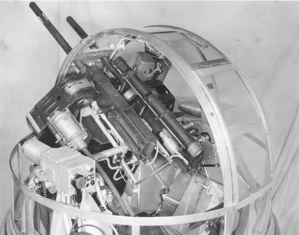

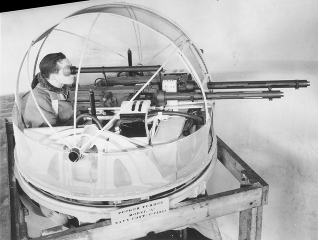

Here are a couple of photos of Tucker turrets that I came across at National Archives while doing research.
One appears to be a mock up while the other looks like a production model.
These must have been real early or just before WWII judging by the guns. The 50 cal guns have slotted cooling jackets and the early vertical style back plate.
The interesting thing was that the folder that the images came in was marked as "turret for Army flying boat". In the one image you can see a sign that states the turret was for a Navy contract.
I wonder if this turret was used on the bow of the Coronado. It certainly is not the one used on the Mariner.

Looking at the pics of the turret, is it operated by that single pistol grip below the 50's. :?
