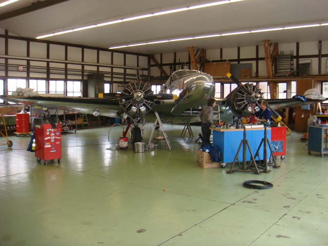

I am working on a Twin Beech in Grenchen, Switzerland and I thought I would post a few shots of the goings on.
I am over here for an annual inspection and a spar X-ray followed by some flight training with the owner and two of his pilots. This Beech is an ex RCAF 3NM Navigation trainer.

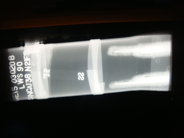

Here is a shot of one of the X-ray films. Look Ma no cavities! This is one of 40+ plus shots required to make sure the Twin Beech wing is good to fly for another 1500 hours.
The steel spar on this particular Beech is as perfect, or imperfect, as it was the day it was made. Not a speck of internal rust or any cracks showed up on the X-rays. Pretty good for a Beech made in 1952. I wish all other Beech's fared so well.

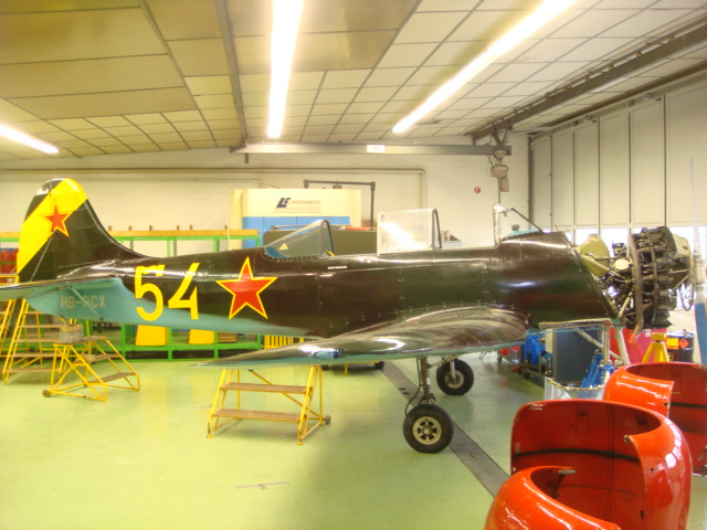

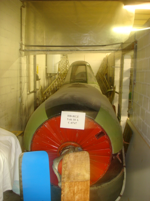

In one of the hangars is a YAK-18. and another project tucked away in the back

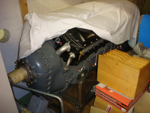

Next to the project is an Allison
which I was told is for this aircraft that is presently in Russia
The people here are wonderful and the mechanics are real sharp. Their shops are so neat and clean it makes me want to go home and throw all my crap away!

Great pictures Taigh. I was wondering if you might be able to post a picture of what a bad spar would look like in an x-ray. That is quite an interesting process you use.

I too would like to see more pics of the spar x-ray process if you ever have a chance to post.
