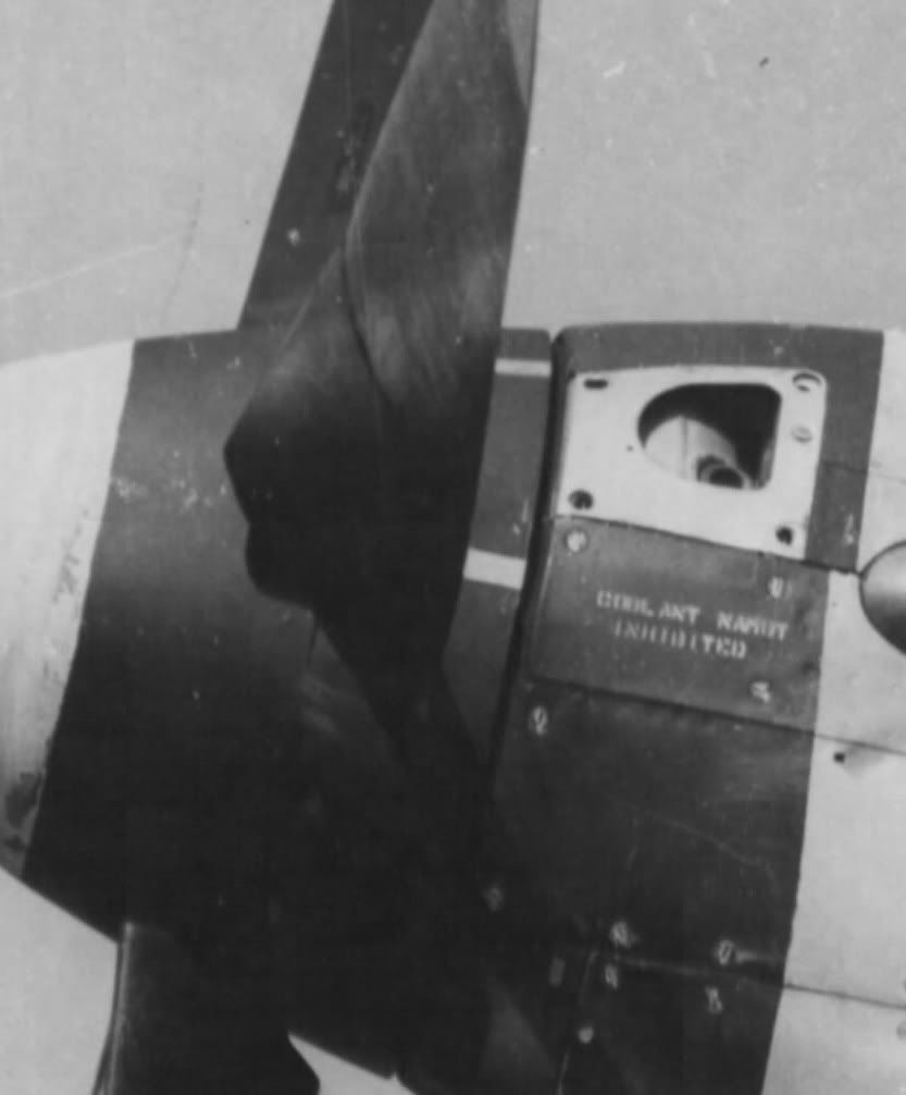

On some P-51Ds there are 2 stencils on access panels aft of the spinner.
What do they say????
Here's one I can partially read it....................................
Coolant Na____ Inhibited
It is a chemical added to the coolant or a type of coolant.
NAMBT possibly?

Well cr*p no wonder I couldn't make sense of it.
Do you have any idea what the stencil says on the other panel??
Here it is on Ilfrey's a/c...

I believe "NaMBT" was a coolant additive that was developed specifically for the Merlin to counteract the dissimilar crossive effects that the Merlin had with the copper & light alloy aluminum parts used in construction of the engine. This is a common day problem that will haunt a Merlin that is not operated on a regular basis. Some guys use a over the counter product (Automotive) that just does not do the job. :shock:

There is a std stencil for the small panel that is open. The small round opening inside is where you add the coolant to the main coolant system.

I have the blue print for P-51D stencils hanging in our lobby. I am at home. I believe it states coolant spec and quantity.

COOLANT NAMBIT INHIBITED :shock: :shock:

Do the 2 white marks have any significance??

On the panel not shown in the first shot, the only stencil I have seen on it reads:
Coolant
Filler
Filler Instructions Inside
This looks to be a bit different however.

Jack Cook wrote:
OK-OK so it's actually a large angry lizard :roll:
No those are on the prop spinner. :?
Might index the aft spinner to the #1 prop blade.
Also there were marks on some spinners and prop blades to aid in sighting the gun camera. There was a mark on the center lower carb intake. Align with the mark on the spinner. One mark allows you to sight gun camera on a distant ground target. The other spinner mark aligns a prop blade. On the back of the prop blade was a series of range marks that could be used to sight the gun camera as well IIRC.
