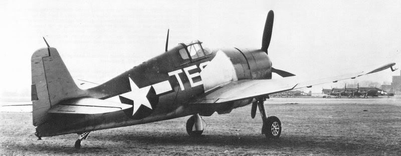

Definitely to be! Would've manifested itself in the F6F-6, but which never went into production.

BDK,it was a Bearcat, but not sure if it was Don's or not.There was a dozen hangers and it was sitting in one that we didnt move alot of airplanes around in. Dan, great pic.wonder what kind of performance it got.

kenlyco wrote: Dan, great pic.wonder what kind of performance it got.
Approx. 410 mph at altitude. Believe F6F-6 would've used R-2800-18W, but engine production was directed toward F4U program instead.
I've always thought it would be cool to display one of the modern Hellcat flyers with the "TEST" paint and four blades.
