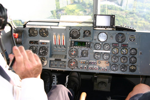

PostPosted: Sun Jul 13, 2008 4:35 pm
Joined: Tue Nov 06, 2007 5:34 pm
Posts: 187
Location: NW Mississippi
Upper left.
From a picasaweb site for a ride in a Goodyear Blimp.
http://lh4.ggpht.com/_OpZd3ayUdeA/RO0ZW ... G_8003.JPG
Sully
PostPosted: Sun Jul 13, 2008 5:06 pm
Posts: 3299
Location: Phoenix, Az
Sully, that link did not work
PostPosted: Sun Jul 13, 2008 5:18 pm
Posts: 187
Try this.
http://picasaweb.google.com/msheppard/20060823BlimpRide
Lower Inst panel then hit the magnifing glass in the upper right corner.
Sully

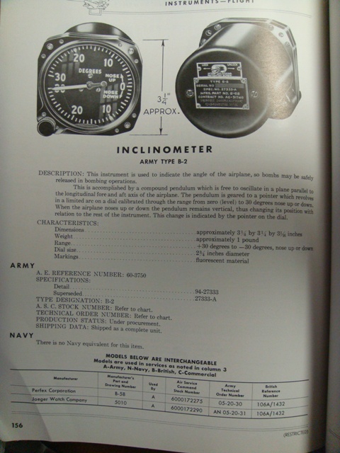

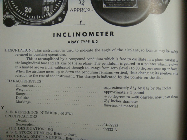

PostPosted: Mon Jul 14, 2008 7:16 pm
Posts: 1487
Found it:
If you ever see a shot of the instrument installed in a WWII panel I would certainly like to see it.
If you all would ever part with your inclinometer, or come across another one, please keep me in mind as I would like to pick one up to go with the bombing equipment collection in our little museum.
