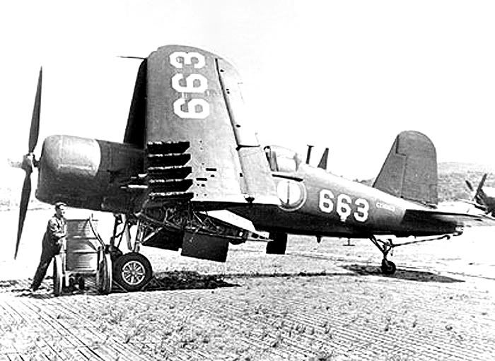

This picture via FAH619

It's an F4U-4C, I can tell you that much.

Hi,
I think it is not a -4 but most certainly a -7, probably painted as a Us Corsair after she was retired from french navy and given back to US and put in storage??
There is some typical parts belonging to -7:
_ the cowling is not circular but have cheeks like -5 or AU-1
_ the radiators are not in the wing air intakes entry but moved in the back
_ there is a central ordnance pylon in central point fuselage which has a slot to allow intercooler flaps to open.
_there is 5 underwing pylons
_wings seems to be covered by metal instead of fabric.
Does somebody know where and when this picture was taken?
PostPosted: Sat Oct 04, 2008 8:30 am
Posts: 2676
You may be getting confused with the F4U-1C. The F4U-1C and F4U-4B have 20mm cannons. There weren't any F4U-4C's.
Pic is most likely an F4U-7 as mention above. You can just make out the top of the "shark fin" antennae.

PostPosted: Sat Oct 04, 2008 8:57 am
Joined: Sat Dec 08, 2007 11:05 pm
Posts: 656
gale_dono wrote:
Did the -4B have cannon? I don't remember otoh. Also that's not a totally accurate statement, I could certainly be wrong. I've been wrong plenty of times before XD
Actually, I was asking you ,because I dont know how to tell the difference
PostPosted: Sat Oct 04, 2008 10:10 am
Posts: 942
Location: Greeley, CO
Agreed on the conclusion that it is a -7 model....bulged cowl cheeks like a -5 but the scoop is underneath is the dead giveaway of a -7, that and 20 mm cannons....never heard of a F4U-4C...wonder if this baby is still with us?

The initial photo is defiinitely an F4U-7, repainted in a US scheme, probably after being returned to the US. Only a handful of -7's returned to the US after use in the French Navy. Could this be the aircraft which used to be at the USS Alabama memorial museum (now at the USS Midway)?

I never heard before of -4C and I have no document on this type of aircraft.
Do you think it is possible that the navy gave a new designation to the last corsair on duty after upgrade or special duty. For example in France we have operated F8E (fn) Crusader, after the last upgrade, we changed the designation for F8P (P= Prolongé = Prolongated)
Concerning the -7 of the first pic it could be one of the following which was sent to the US in 1965:
133693 - crashed at mojave in 1987, painted as Blue Max
133704 - on display in US Museum modified with a AU-1 cowling
133710 - ?
133714 - Airworthy, painted as Alberta Blue
133722 - Airworthy, rebuilt with a -4 cowling, in Oregon
PostPosted: Sat Oct 04, 2008 3:26 pm
Posts: 1536
My guess is that the plane in the photo is F4U-7 BuNo.133704 as displayed in Pensacola sometime between 1965 and 1977, prior to being relocated for display at the USS Alabama. The paint looks like a crude white wash to me, judging from the tires and the effects of weathering.
