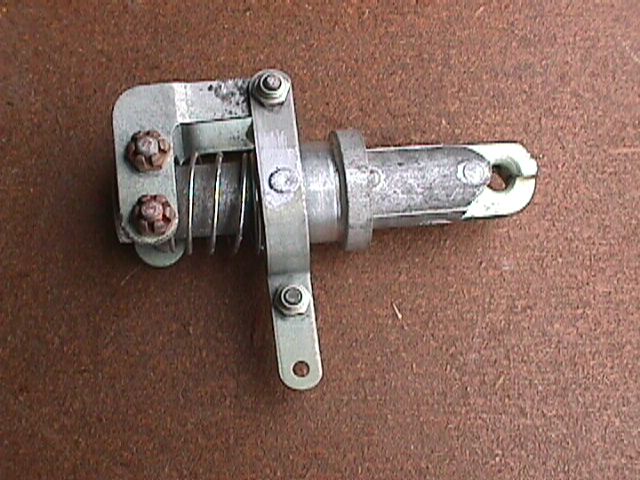

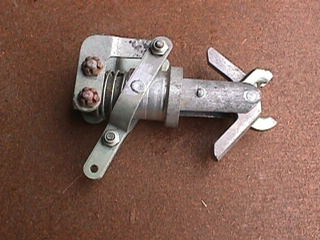

Take a look at the device below. This is the attach angle for the emergency braking parachute on a WWII CG-4A Glider. I have had a customer or two use them for making a release for a hand-propping tie down. I haven't tried it for that purpose, but think it is essential to tie down your aircraft if you are hand propping by yourself, which I know nobody ever, ever, ever does...
REMEMBER THE SERGEANT PILOTS!
