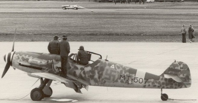

109 gear had an other oddity see the angles of the wheels here:

Hey Juke..nice shot of the Finn 109. I've been curious about 109 tire wear.
Did the mechanics..at some point of service, "flip the tires around" in
order to extend the life of the tires? Perhaps a question the Buchon
guys could readily answer?

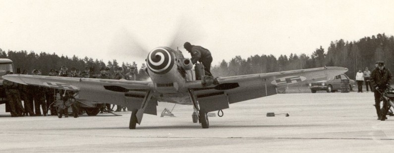

Here is another from 1971 runup of MT-507 !
Some of the pics in your link are borrowed from here:
