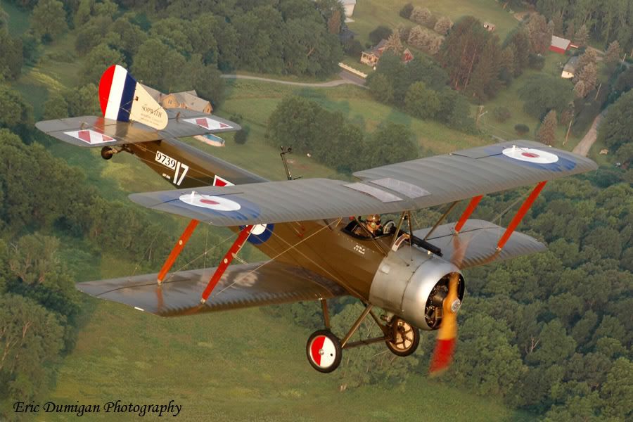

We have a couple of those 220 Continental stuart tank engines at the Great War Flying Museum, one of which powers our full size Sopwith 1 1/2 Strutter replica. When we got it it had all the reduction gear/fan assembly bits on it. It has had some problems, mostly relating to the conversion process of tank-to-aircraft engine, but the kinks have been ironed out by now.
