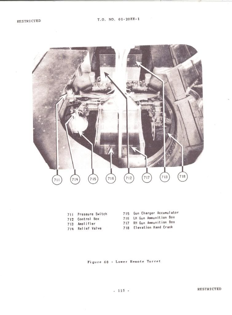

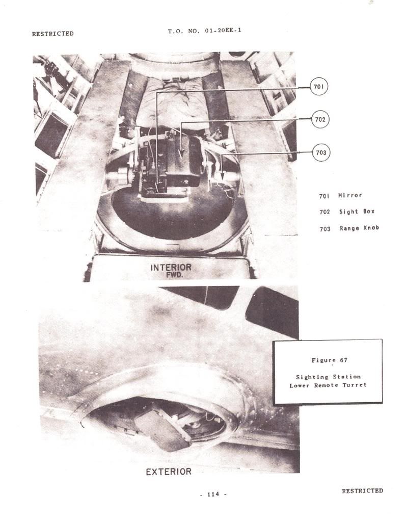

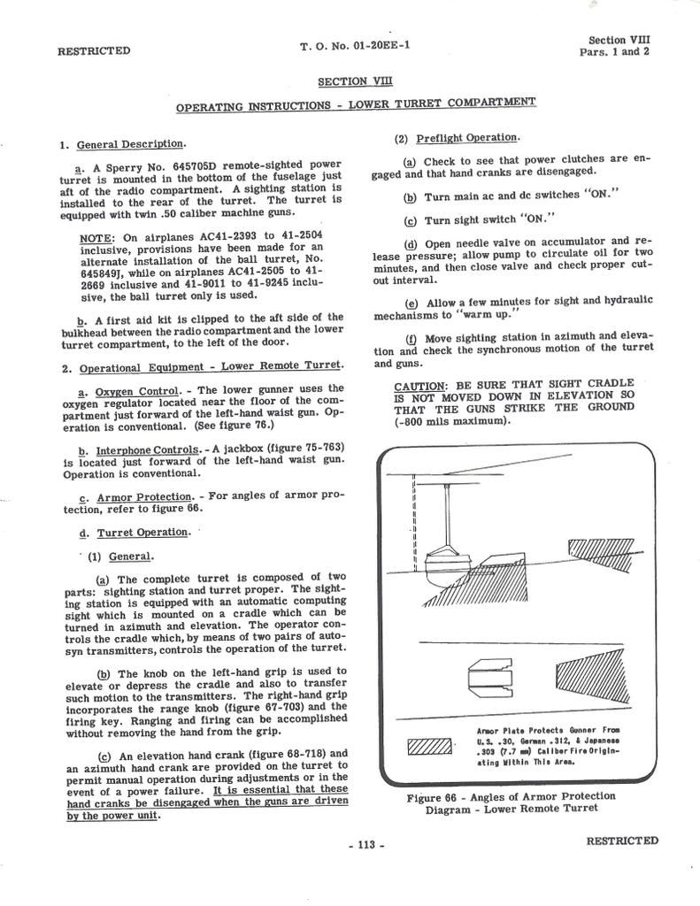

Without going through the whole thing again (for more on this, see also http://www.aerovintage.com/b17news8.htm, December 2008), this excerpt of the B-17E manual is conclusive:
And, as stated elsewhere, the AAF Gun Turret study listed in the first posting is also conclusive as it clearly states Sperry designed the dorsal and ventral (both remotely sighted and ball) turrets for the B-17.

I found these instructions for the Sperry Lower turret installation in a B-17E manual
I have similar material from an early B-25 manual showing the instructions for operating the Bendix turret.Sorry that the pages are slightly off center.That seems to be a quirk with this particular computer and scanner program.

Well there you have it. The information from Larry and Aerovin shows that the AAF considered this a "remote" turret because the sighting station controlled the gun system via two autosyn transmitters. This was not a "local" turret. I wonder if anyone ever managed to shoot down an attacking plane using this turret system?

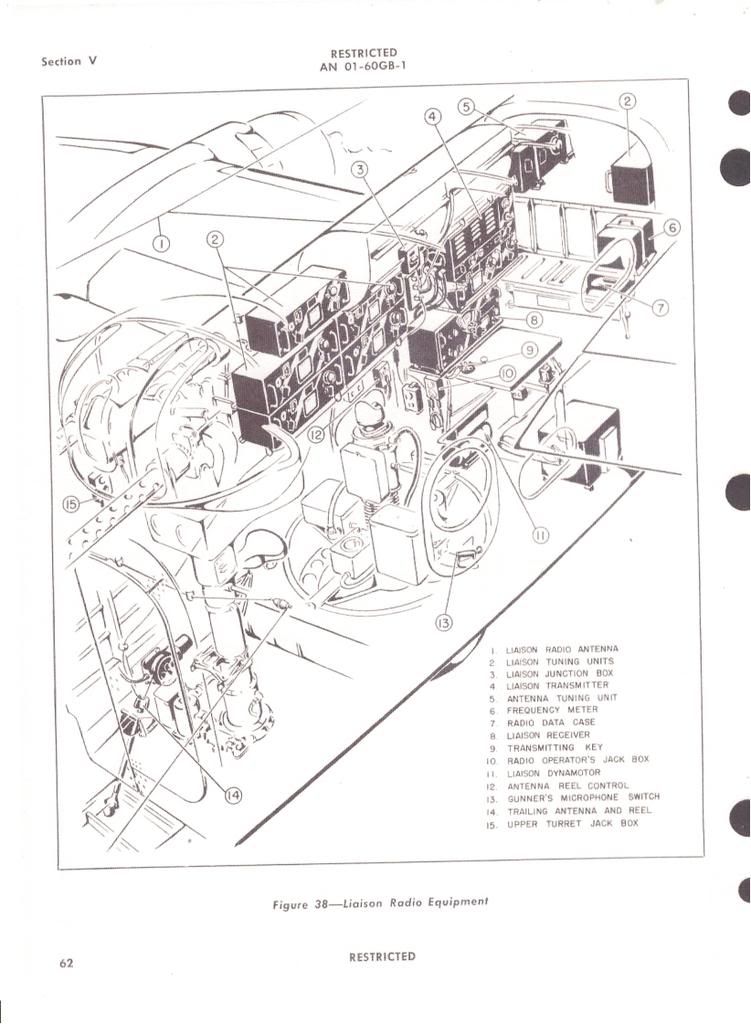

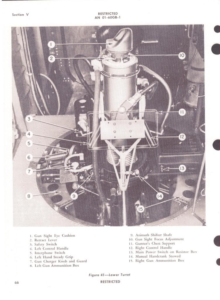

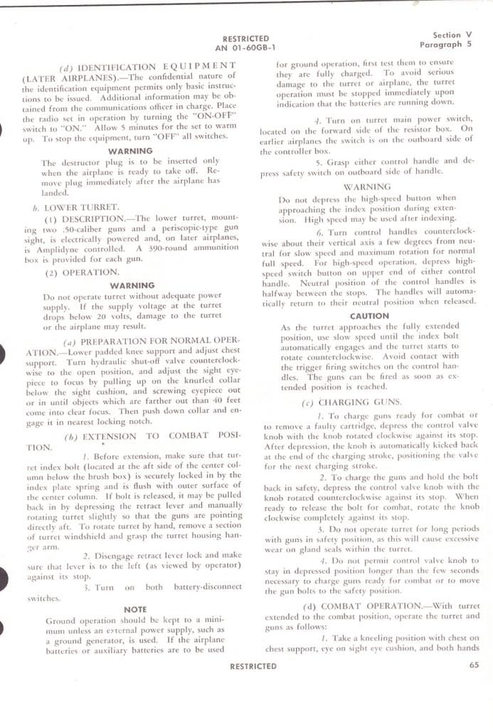

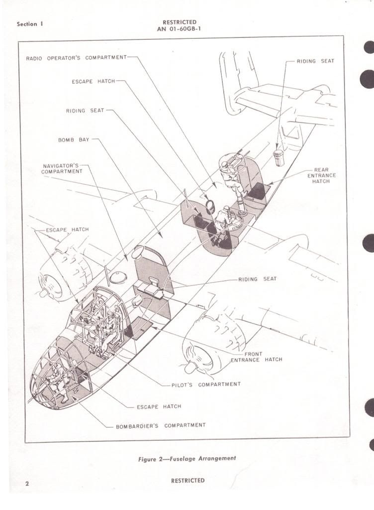

Just for comparison purposes,here are the pages from a B-25 manual on the operation of the Bendix lower turret
