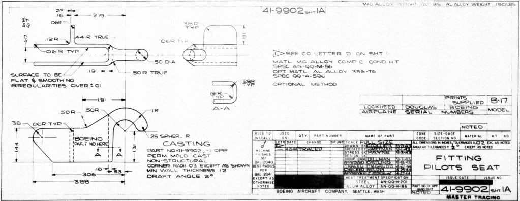

Definitely a B-17 :
This is part of the pilot/copilot seat adjustment mechanism.
BTW: Boeing did build early model A-20s under license from Douglas
early on.
-Bill
