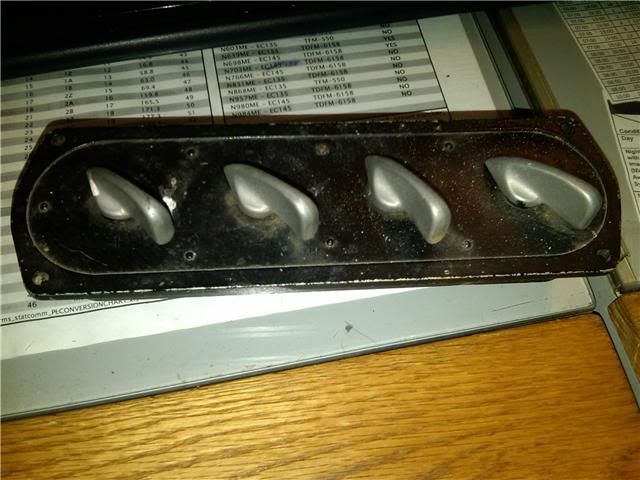

My friend and I used to work in a fliht school together, and when he got promoted to maint. manager, he got a new office. This office is located in an upper hangar at the Beaver County Airport. This hanagar is where 909 was restored after it overshot the runway and crashed in the late 1980's. Well a while back he was organizing an area, and found this part. It has 4 switched all are labeled ignition. The panel says bendix 10-51100 type EW-L. Do you guys think this is a B-17 part?

I'm not as familiar with the B-17 cockpit, but on Ol'927, the mag switches are all together, similar to what's pictured (different style though), and is located on the ceiling, between the two pilots. So it may be from a B-24.

http://www.zenithaviation.com/0410/pdf/ ... entory.pdf
Says that it's a magneto switch/plackard for a R2600.

NSN 5930-00-439-0111
It's from a B-29
5930-00-439-0111 Characteristics Data
MRC Criteria Characteristic
APCR INDIVIDUAL SWITCH QUANTITY 2 AND 2
AEEA SWITCH TYPE ROTARY
AMSA CONTROLLING AGENCY BENDIX CORP
AMSB IDENTIFYING NUMBER 10-51156 PART NO. AND 10-28238Y PART NO.
ABHP OVERALL LENGTH 9.062 INCHES NOMINAL
ABMK OVERALL WIDTH 2.812 INCHES NOMINAL
ABKW OVERALL HEIGHT 2.562 INCHES NOMINAL
ADJH MOUNTING METHOD FLANGE
ALGC MOUNTING CONFIGURATION 4 MTG HOLES 0.206 IN, DIA ON 2-5/16 IN. BY 7-15/16 IN. MTG CENTERS
MARK SPECIAL MARKINGS OFF, R, L, BOTH, 1, 2, 3, AND 4 MARKED ON PANEL
AGAV III END ITEM IDENTIFICATION MODEL NO. B-29
SR-5 MANUFACTURERS CODE 28839
SR-5 DESIGN CONTROL REFERENCE 10-51100

aseanaero wrote:
It's from a B-29
Sorry, but nope. Definitely not B-29. As a Flight Engineer on the -29, I can tell you that it has two seperate mag switches, one on top of the other.

It doesn't look like any B17 mag switch I've seen--they are in pairs in a round housing on any I've seen in person or pictures.

The part is definitely not from a B-17. B-17's used (2) B-5 mag switches stacked on top of each other and gang-barred together. Definitely not B-29 as it used (2) B-5 mag switches also. They were located in the engineers panel facing the back of the aircraft. They would be marked 4 and 3 & 2 and 1 as the engineer would be reading from his left to right.

I found one on ebay that is described as a B-29/KC-97. My friend said that he would sell it, if any of you guys think it may be of use to your restorations or collections. He says he has no idea of the value, that just be honest with him, and he can work out a deal.
