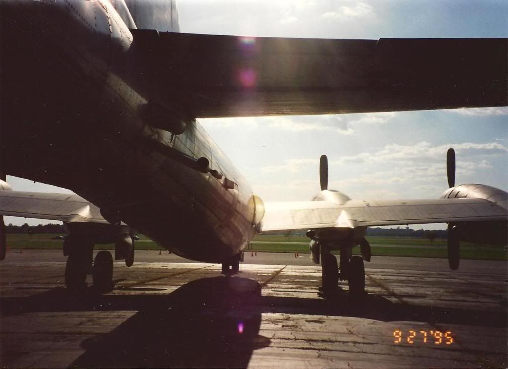

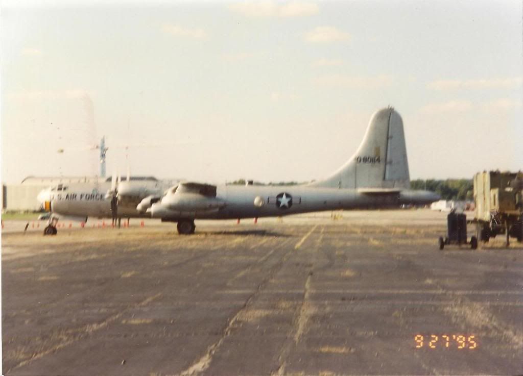

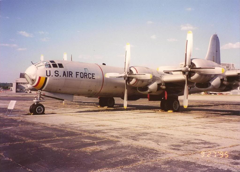

Ser. No. 49-0389 back when she was in Dayton just prior to shipping out to MacDill AFB.
