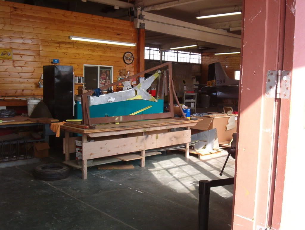

I can relate to the difficulty of building a jig for an aircraft with limited data. Many of the drawings for the P-35 series are basically unreadable and no spare parts or wrecks are available for teardown & study. All existing airframes are assembled and thus limited data can be gained. However other rebuilders have done it and here are some examples:
Here a are some P-51 jigs from Fighter Rebuilders at Chino:
Here are some "vintage" shots from Boeing of B-17 jigs:
And here is a "modern" shot of a B-17 in a jig (Liberty Belle)
Finally here are some Republic P-47 shots:
Here is my favorite, the rear fuselage and entire fuselage of a Seversky P-35 under construction in a factory jig (both of which I hope to copy for my replica new build)
Here is my start, it not intended as an assembly jig, but rather a "proof of concept" to determine the best way to construct a proper jig for my P-35A replica project:
