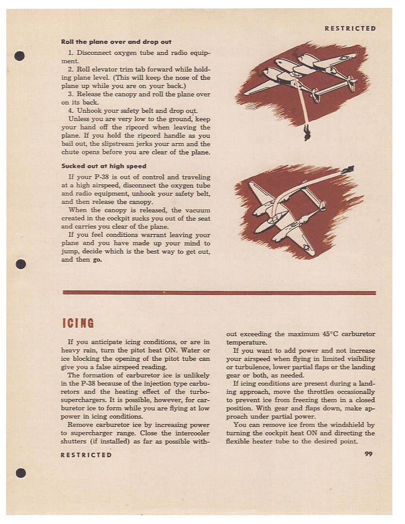

Trimming nose down brings the stabilizer down as you are dropping out inverted. Are you sure that is a good idea? Will you drop out faster than the tail goes down?
The reason for jumping towards the wing is that the natural aerodynamic downwash from the wing (you have to throw the air down to support the plane) will carry you below the stabilizer.

Trimming nose down wouldn't bring the tail down, it would climb up and away. I don't think even a full nose down trim, which you wouldn't have to do to get out, would make the tail sink down below the flight level. The entire plane would just climb, inverted. Just like in formation, when one pulls up for the missing man, the tail doesn't drop.
This is the method Sandy used to get out of his on-fire P-51B over France, and said he would use if he needed to get out of the P-38. It's also the procedure that Ron Iberg told me he would use if he needed to get out of a T-33 that he drives from time to time that doesn't have hot seats.

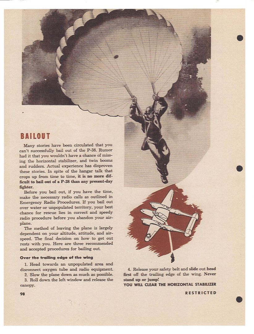

PostPosted: Wed Dec 16, 2009 4:17 pm
Posts: 848
Location: Redmond,Oregon
Mudge,
Here's what the P-38 Pilot Training Manual has to say,which pretty well matches the postings above.

...he always said the best thing to do is dive onto the wing as the trailing edge down force would blow you down well clear of the tail. Inverted would be a last ditch move IMHO as you would want the aircraft to be almost completely stalled to get clear of it.
