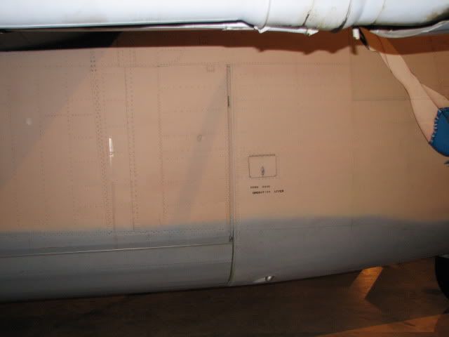

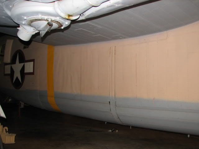

Here's the pic of the Strawberry showing the open bombay doors, from my well-worn copy of Birdsall's book (I've had it since the late '70s.)
And here's one posted on WIX awhile back showing her being prepped for her final flight from Tuscon to Dayton.
I've actually crawled through Strawberry's bomb bay (back when the NMUSAF still did "open cockpit" events) and can confirm that she has the same "roll up" doors as all other B-24s. I took a bunch of detail shots on one recent visit..here are a couple that show the door tracks to good advantage. I'm actually surprised the museum doesn't have them open. Most of their other WWII bombers are displayed with open bombays.

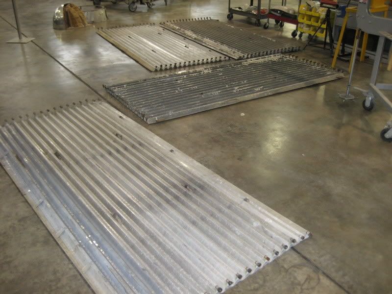

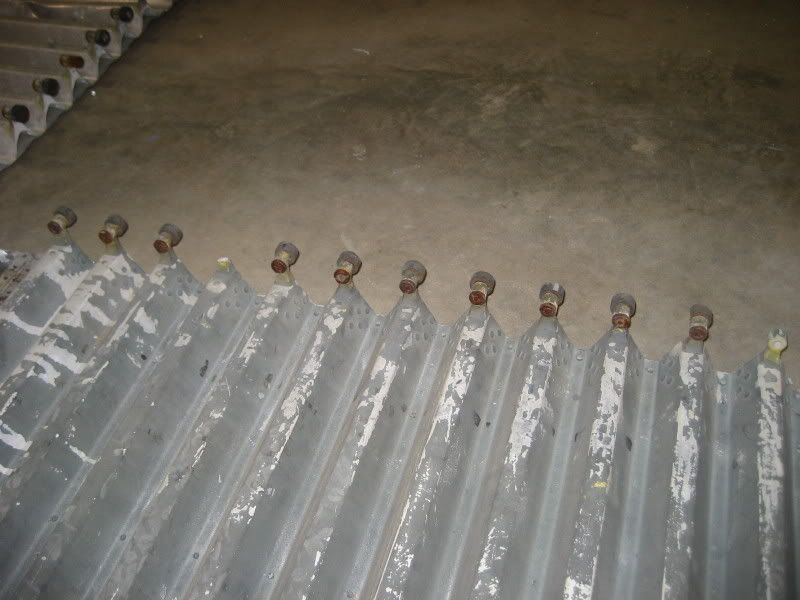

I found a CD of reconfiguration photos, so here are a couple of pictures Gary took of the bomb bay doors just after they arrived. You can easily see the rollers and their brackets. The rollers ran in the tracks riveted into the fuselage, and the sprockets meshed with the roller brackets to drive the doors open and closed.
