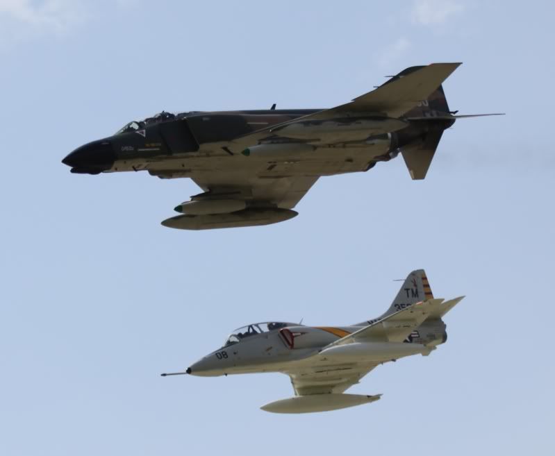

We have a quote posted inside the nosegear door of the F-4.
"The Impossible is Possible ! "
More than one skeptic said these would never fly !
But having said that, these are of more conventional construction. Even the honeycomb is repairable using fairly straightforward techniques.

I agree that older, more 'sheet of tin' aircraft can be brought back with enough money and time but both the A4 and the Rhino are mid 50's design technology. If, forty five years from now someone stumbled onto an abandoned EUROFIGHTER airframe that had been completely stripped of all it's wiring and electronics and computers, it most likely couldn't fly again as that individual would need to design and manufacture computers and wiring harnesses and connecters to make the flight controls operate, and the airframe would have most likely have been 'de-milled' with DOTCOs making safe repairs all but impossible to the average guy. "Tom, I'm gonna turn the two car garage into a big autoclave" won't happen unless you are Paul Allen. Nothing is impossible, but I doubt that TITANIC will ever make port. There is a vast ocean of difference between the good Doctor patching his SE5 with a shirttail and some pot glue and doing the complex math of how many laminations and in which specific directions in what order, under what heat and pressure you need to repair the big hole that was cut out of your newly aquired CFRP jet hulk.
