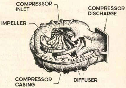

Some Thoughts on Understanding the Operation of a Turbocharger
What initially made comprehending a turbocharger difficult for me - and I imagine at least a few other people - is the way it appears to be a perpetual motion machine. To put it another way, it seems to be a chicken and egg situation, where it needs A (exhaust gasses) to generate B (compressed air), but also B to generate A. This doesn't make intuitive sense. How can a device power itself?
Now, I know at this point everyone is going to want to chime in with an explanation. However, that is not exactly the point of this post. I mention this because, while I have long since understood it, it might help explain why the average person may struggle to understand the way it works at first. I don't hide the fact that I am neither a pilot nor a mechanic and did not come into aviation through either of those means. As a result, there are sometimes concepts I encounter that the average aviator takes for granted. The flip side of this is that I come at the subject the same way a visitor to a museum would and so I can put myself in their shoes when considering how to approach a subject.
Indeed, the reason this topic came to mind is that I re-encountered it while attempting to write a label explaining the sequence of events by which a turbocharger operates. Specifically, the issue was where to begin the narrative. There are two options: with the intake of atmospheric air or with the intake of exhaust gasses? In other words, with the source of power for, or the results of, the turbocharger's work. In the end, I went with the latter, but it is equally possible to start with the former.
Furthermore, this is not the limit of this circular power problem in aviation either as the situation is the same with jet engines (the turbine powers the compressor and the compressor supplies compressed air for the turbine) and, to a certain extent, even the electrical system which runs a piston aircraft engine (the engine powers the magneto and the magneto provides spark for the engine). Again, both of these took a while for me to understand.
So, I went a bit off topic with this post and I'm not exactly sure how to end it. However, in an attempt to give it one I'll close with this: it is always worth considering that what may be obvious to someone who has been in the industry for a while is not always so clear to those on the outside.
