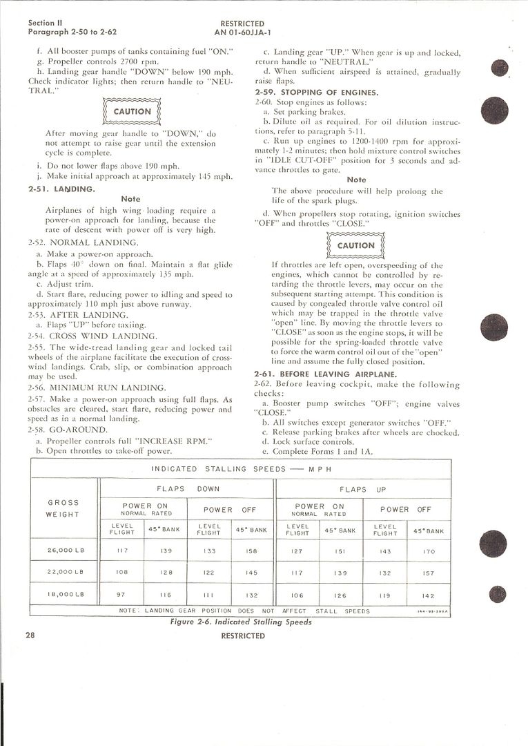

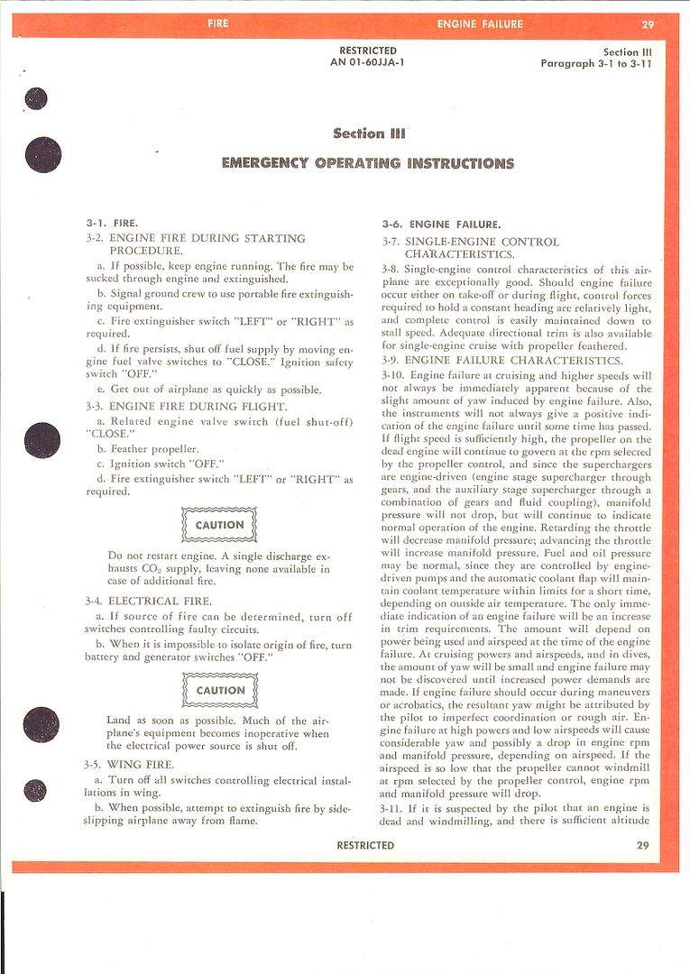

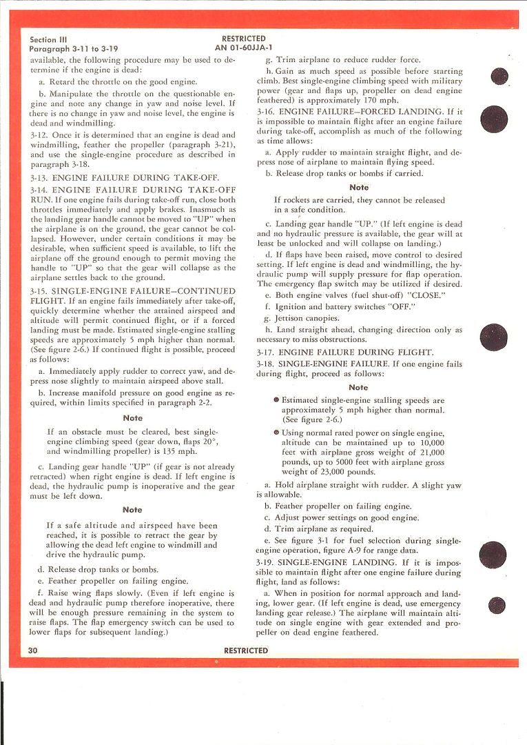

I don't know if it will help,but here are some pages from the F-82E flight manual that pertain to stall characteristics and engine out procedures.Paragraph 2-39 states that there is little or no stall warning in the landing configuration.Figure 2-6 gives the indicated stall speeds and Paragraph 3-15 in the Emergency section says that the stall speed in a single engine landing will be about 5 mph faster than normal.

"However there is little or no stall warning with the flaps and gear down, power on or off, and flaps and gear up, power off."
Depending on where Ed lost the engine, he might have had little warning about an impending stall, with little time to react, especially if he was close to the ground.
"Should engine failure occur either on takeoff or during flight, control forces required to hold a constant heading are relatively light, and complete control is easily maintained down to stall speed."
It sounds like this is relatively easy to fly single-engine, PROVIDED one is above stall speed. I haven't seen the rest of the manual, but the omission of any problems with Vmc issues in the single-engine emergency section implies that it is not an issue at all. At the beginning it even remarks that "single engine control characteristics of this airplane are exceptionally good".
"Estimated single-engine stalling speeds are approximately 5 mph higher than normal."
This is key. In this scenario, we can refer to figure 2-6, page 28 of the pilot manual that Larry scanned. Let's also assume that the CAF aircraft was a lightly loaded one with no armament, combat equipment, etc. In that table, I will use the following conditions: flaps down, power on, normal rated power, level flight, and 20,000 lbs, which is exactly half-way between the 18,000 and 22,000 lb columns (a light weight aircraft), so we can interpolate half-way. The stall speeds for 18K and 22K weights are 97 mph and 108mph respectively. Interpolating, we come up with a 103mph stall speed for the conditions which most closely approximate a two-engine landing at Harlingen. The manual (see above quote) states that for single-engine, the stall speed increases by 5 mph. So, 103 mph + 5 mph = 108 mph stall speed for a single-engine condition.
So, his actual single engine stall speed is 108 mph, which converted to knots equals 94 Knots indicated air speed. Thats a difference of 14 units between the two measurements. Whatever he thinks he is using, he is going to be off by 14 units on what he thinks his stall speed is. If he thinks he has until 94 knots until he stalls, but in actuality, he is flying 94 mph because the airspeed indicator is calibrated in mph, rather than knots, he will actually be 14 mph too slow and fall out of the sky. So, from this perspective, it is very easy to see that confusion between mph and knots calibration on the airspeed indicator is very critical.
Also, from the manual excerpt, we can see that the left engine powers hydraulics for the gear and flaps. From Chunks' pictures, we can see with no doubt whatsoever, that the right prop is feathered, hence he lost the right engine. Losing that side will not affect his ability to lower his landing gear or drop the flaps like he normally would do. So, no distractions there for Ed when he was configuring for landing.
Using normal rated power on single engine, altitude can be maintained up to 10,000 ft with airplane gross weight of 21,000 lbs, up to 5000 ft with airplane gross weight of 23,000 lbs
With our scenario of using a 20,000 lb aircraft, he should be able to maintain level flight above 10,000 ft. Harlingen is nearly at sea level, and will come nowhere close to that. Utilizing the weather observations from the weather data in the NTSB report, I calculated the density altitude to be no greater than approximately 1500 ft, worst case scenario. So, Ed should have had plenty of excess power to not only maintain altitude, but also enough to climb in those conditions on one engine.
