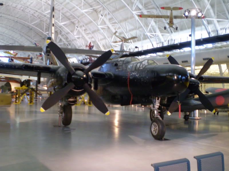

I was out at Udvar Hazy last week doing a walk-through for an upcoming corporate party that my company is providing entertainment for, including the band I play in (nothing quite like getting to go to the museum on the company's dime!). While I had to pay attention to the event coordinator, there still was enough time for me to get a good look at everything.

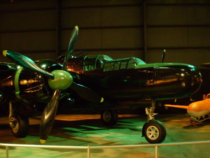

I first went when it opened, so there were a fair amount of planes in the museum that weren't there at my last visit. Of those planes, the P-61 was definitely at the top of my list to see. The one thing that struck me on the P-61 was how wide the propeller blades were. They seemed almost comically wide. I've seen the P-61 at the USAFM in Dayton some years ago, and don't remember the prop blades being as wide as the one at U-H, but, again, it's been well over 15 years since I've been to Dayton. Were those the standard propellers issued for the P-61, or were they experimental, since the plane was assigned to NACA?

They look to be the same/similar to me.

OK-here is the answer from Scott Willey who is the author of our Garber series,and one of the guys who worked on the aircraft...
"The memory of the NMUSAF bird is a bit off. Take a look at the website and you'll see they are the same props. What you're used to seeing is the props on the majority of the P-61s (A and B models) were Curtiss 12-2 models. Constant speed and full feathering for use with the P&WA R-2800-10 and -65 engines. But with the bigger-chord 12-8 blades were used on the Cs and the F-15As with their turbo model R-2800-73 and -77 engines. Both Moonlight Serenade and our bird are Cs and have the 12-8 blades. WEP on those engines was up to 2800 hp, so it needed a little more blade area to translate that into thrust!"

Thanks! That makes sense. It had been 17 years since I saw the NMUSAF bird, so my memory was off on that, but at least compared to the pictures I had seen of the earlier P-61s, they do have wider blades...so I'm not crazy!
