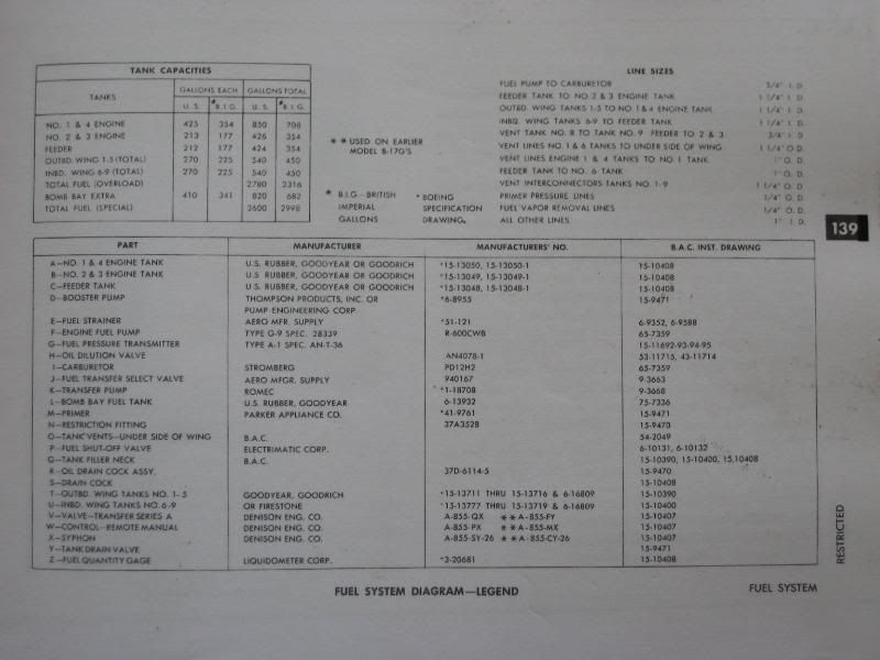

We really got into the aircraft a good bit today, for the first bit of evaluation and cleaning. There are some parts of this B-17 that are almost untouched from the 40's, and then there are some that are just in need of repair. Just a question, we found an extra set of fuel selectors in the radio room. There are also the normal set located in the standard area near the bombay. Anyone know what the extra tank selectors were for?

Posts: 3442
Chris,
Those radio room valves are called remote control valves. They are connected to syphon tubes that lead to shut-off valves on the outer end of the outboard main tanks. These controlled the transfer of fuel from the Tokyo tanks to the outboard mains. Notice that according to my T.O. copy they list these as used on earlier Gs. Your airplane sure isn't an early G, so maybe it was a retrofit. I'll have to see if Chuckie has or ever had these valves. One valve connects the inner four aux. tanks to the aft o/b main and the other connects the outer five aux. tanks to the forward i/b main.
