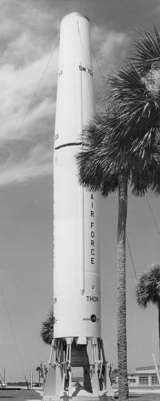

No.139 (57-2647) XSM-75:
The very first Thor to arrive in the UK.
Was on static display at Patrick AFB, FL. LINK
Removed from display sometime after 1991, possibly scrapped. Does anyone know either way?

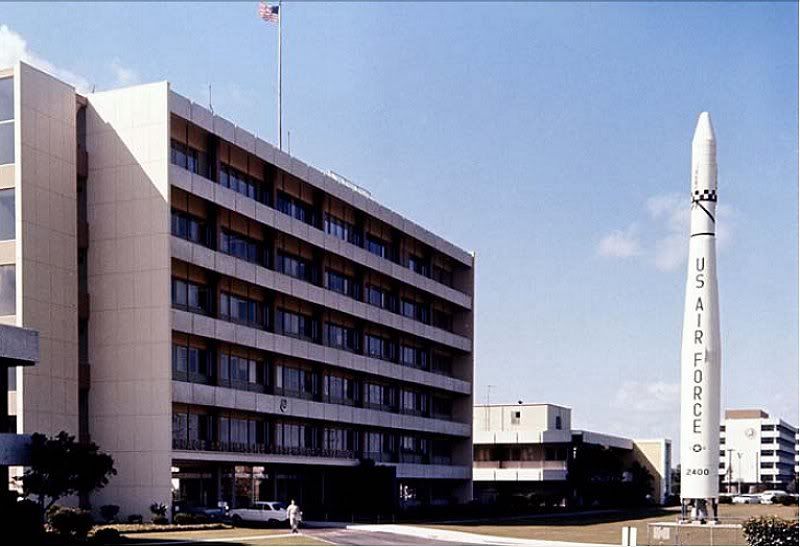

No.157 58-2268 SM-75:
Was on static display (configured as a Thor-Agena) at Space and Missile Systems Organization HQ, Inglewood, CA.
Blown over during a storm in 1975.
Remains may be at Pima Air & Space Museum.

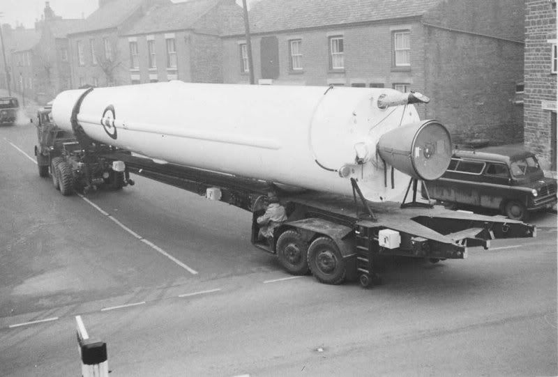

Another Thor in need of an identity... ;)
There is one in basic IRBM configuration on its RAF-pattern (rear-steer) transporter/erector trailer, on outdoor display at the National Museum of Nuclear Science and History in Albuquerque, New Mexico. There is a USAF serial number painted on the boat-tail, but as that's facing upwards I can't read it properly.
Is there anyone local that can read it please?

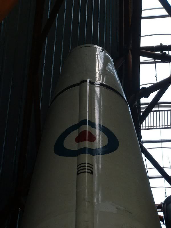

Some detail images I took on Thursday of Thor No.110 (USAF Serial 56-6760), one of the R&D missiles which, following a static-firing test at the Douglas facility at Sacramento, was rebuilt and sent to the UK as the primary training aid at the Bomber Command Strategic Missile School, RAF Feltwell.
As an R&D example this Thor lacks a number of things that were standard on operational Thor IRBMs, the most obvious from the outside is the lack of retro-rockets.
My thanks go to the staff at RAFM Cosford for inviting me "over the barrier" to get better photos without even being asked. :)

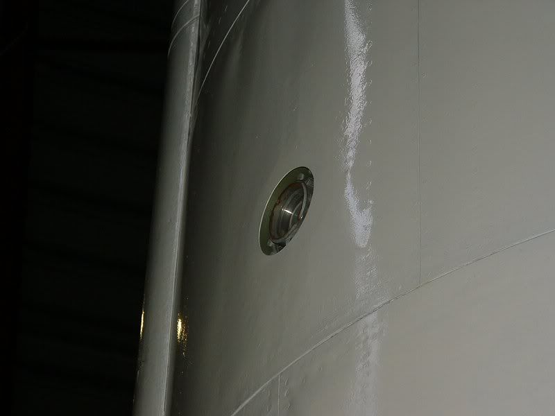

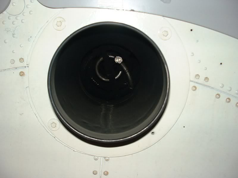

LOX inlet port:

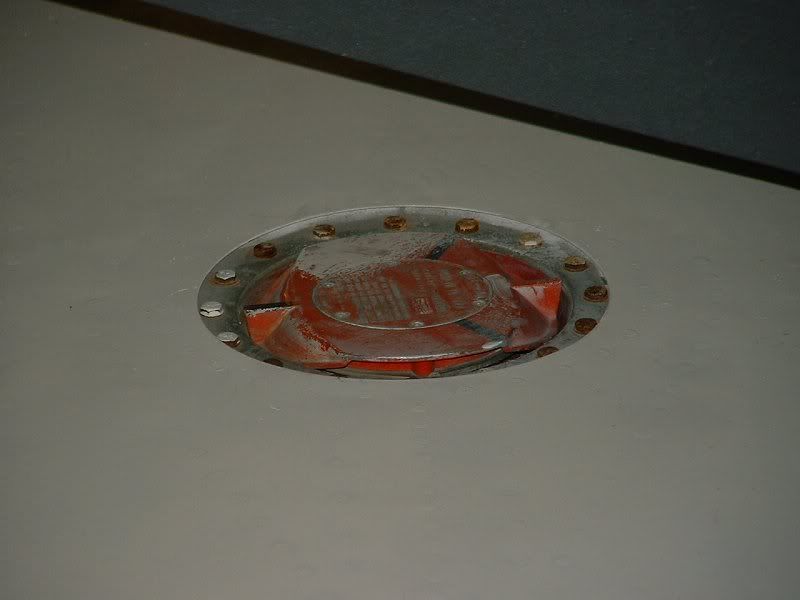

RP-1 (Rocket Propellant No.1, i.e. cleaned and enhanced kerosene) inlet port with transit plug:

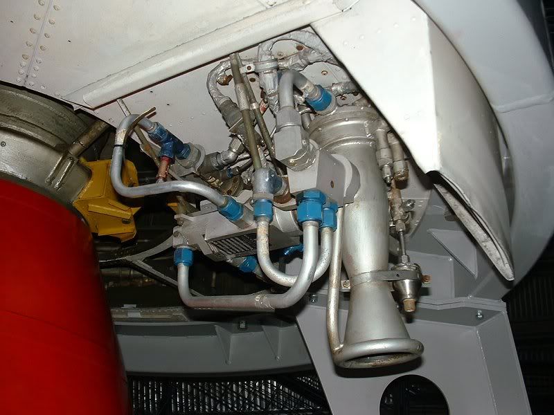

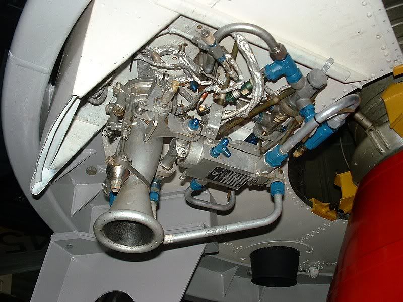

Vernier steering engines with the usual covers removed.

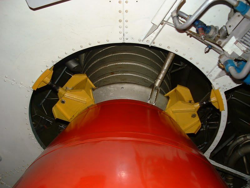

The red item is the transit cover for the main engine expansion bell:
Views beneath and up inside the boat-tail now...
Nice yellow transit clamps to hold the engine bell in place, original Douglas-supplied items:

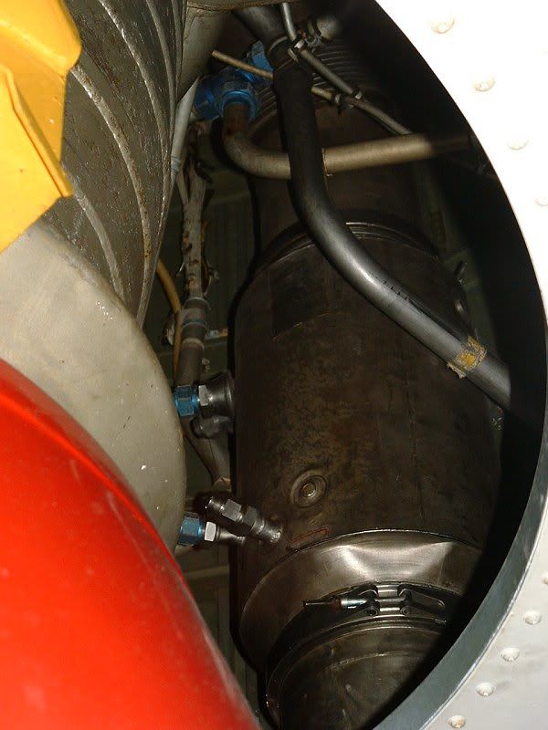

Inside the boat-tail, the heat exchanger unit itself with LOX and nitrogen inlet and outlet connections:

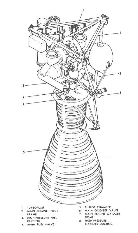

The following photos will hopefully be easier to understand with reference to this drawing of the main engine assembly:

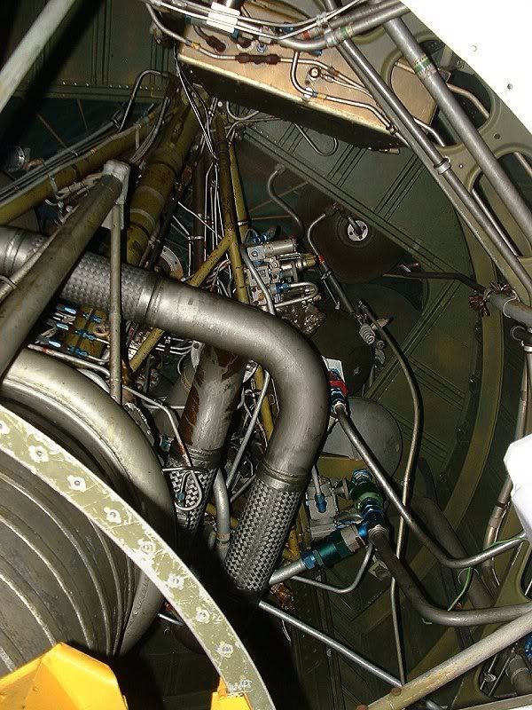

Main engine thrust frame and spherical high-pressure nitrogen bottles (to pressurise the fuel and oxidiser tanks plus power up some of the engine sub-systems), with bottom of the LOX tank right at the back.
The two high-pressure feed pipes can be seen, LOX duct with the brown staining, RP-1 is the cleaner one:

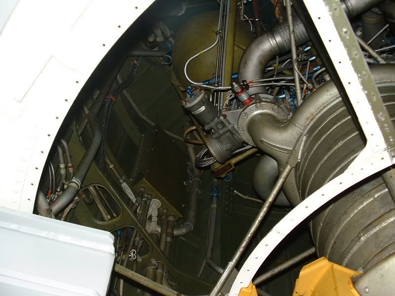

Fuel feed pipe passing from top right through the main fuel valve (centre) into the fuel manifold around the engine bell.
The spherical green tank behind is the turbopump oil supply.
The pipe peeping out from behind the fuel manifold inlet is the main LOX feed duct:

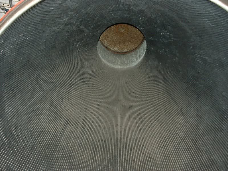

Looking up inside the engine bell, showing the injector plate in the combustion chamber:

No.157 (58-2268):
Formerly on display at the Space and Missile Systems Organization HQ, Inglewood, CA, in Thor-Agena configuration and marked as 59-2400 (ex-Melton Mowbray Thor No.279, launched as Thor Burner II in 1969) .
(USAF Photo)
Remains in open storage at Pima Air & Space Museum, Tuscon, AZ.

This photo from January 1960 shows No.273 in Rothwell on the last leg of the delivery to her launch pad marked as "51":

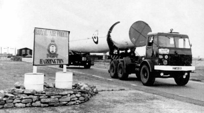

And "51" leaving Harrington in August 1963:

As for 57-2647 on static display at Patrick AFB, FL, I remember driving by and stopping to see several different missiles right next to the road at Patrick. Sometime I believe after the damage done by hurricane Erin in 1995, all the missiles that were left in front of the AFTAC were removed. Most had been outside there for over 30 years only about 100 yards from the Atlantic Ocean. Still think about those missiles on display whenever I drive by this building.
