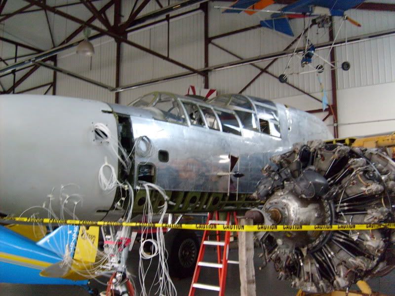

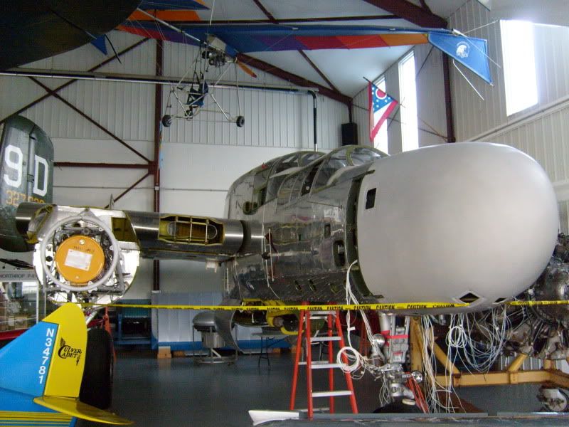

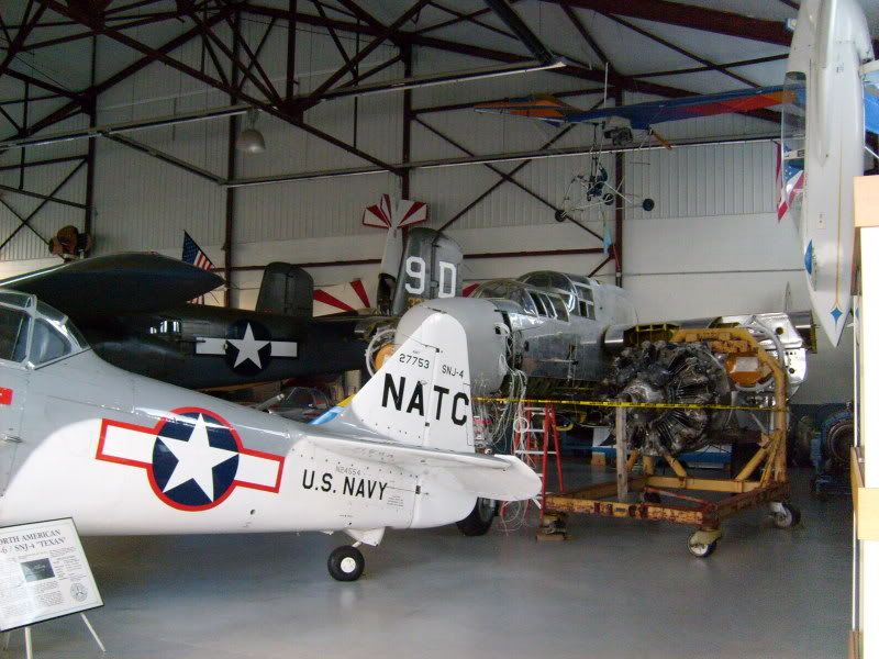

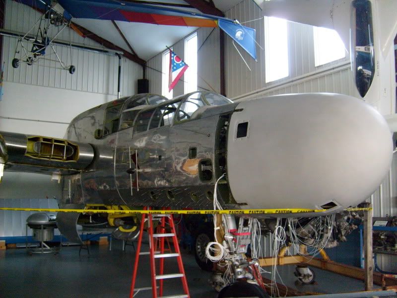

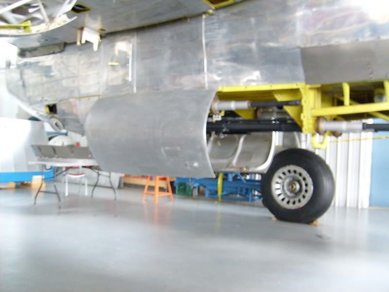

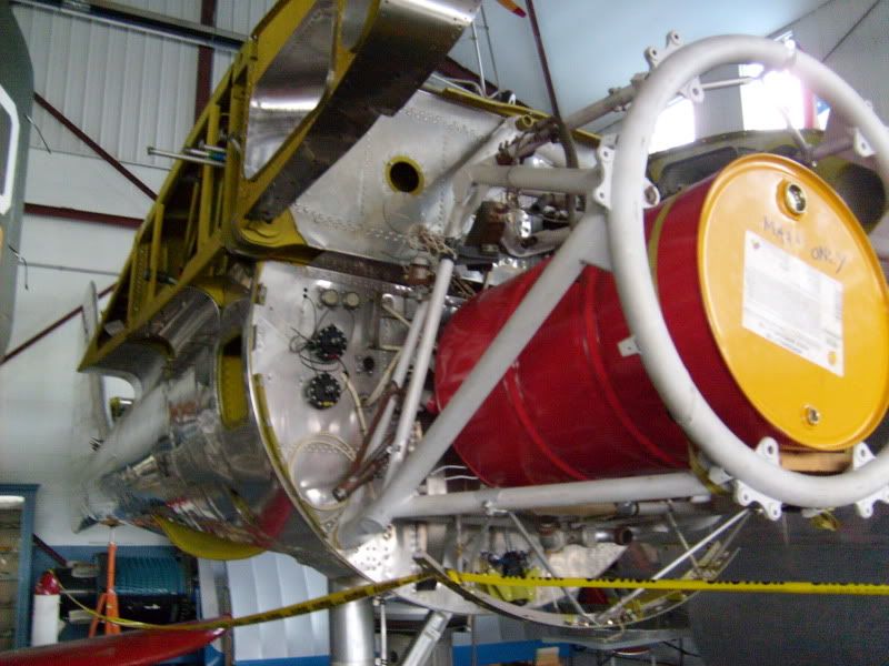

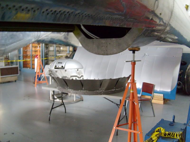

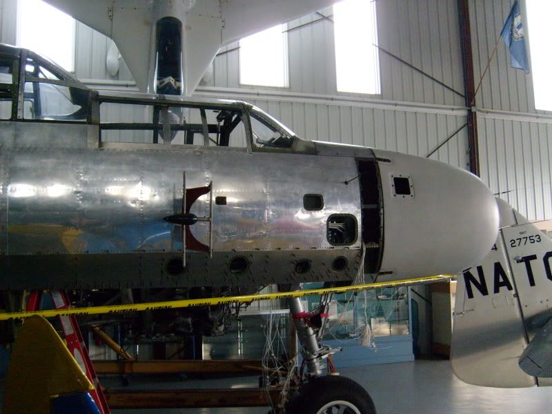

I headed to Reading PA and the Mid Atlantic Air Museum today to check on the P-61.
It is really coming along nicely, the best part is that it is really starting to look like a Black Widow! 8)

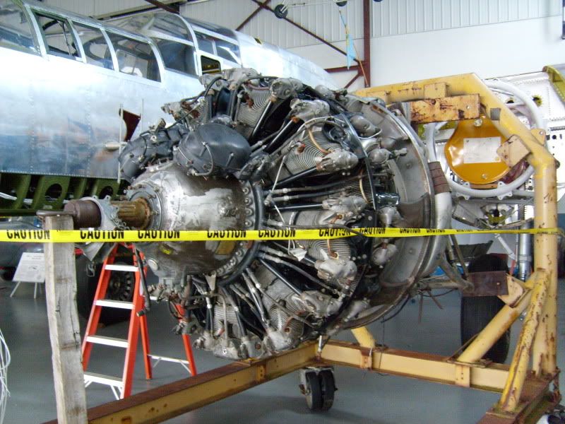

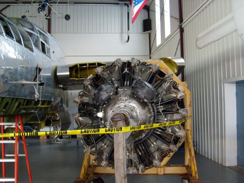

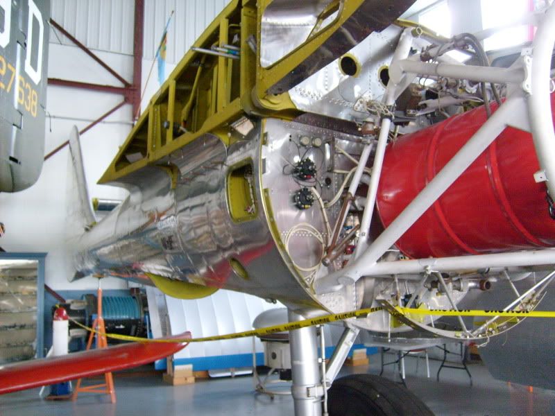

Wiring work is in progress and my tour guide said the motor will be temporarily hung in order to do some cowling work.

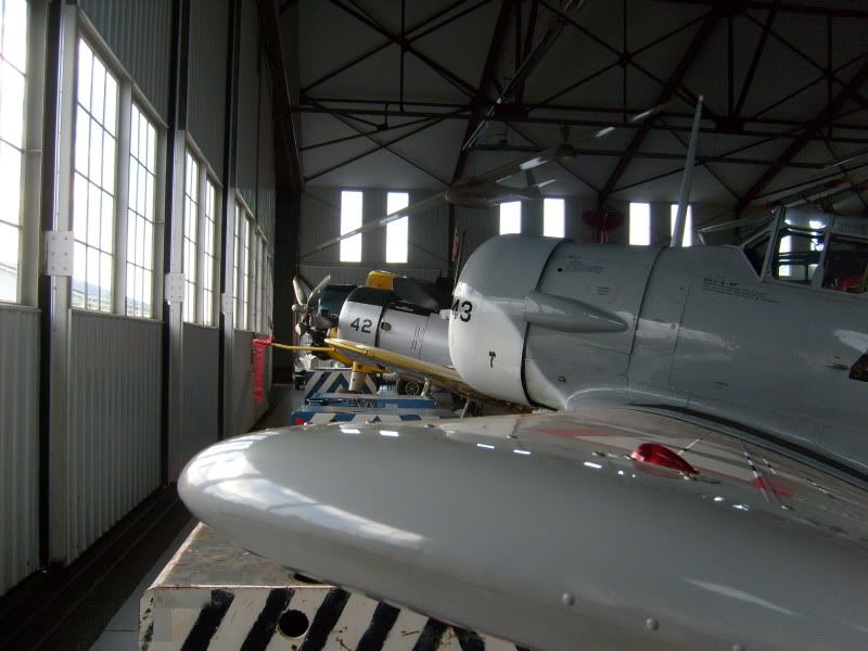

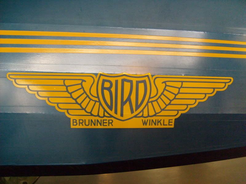

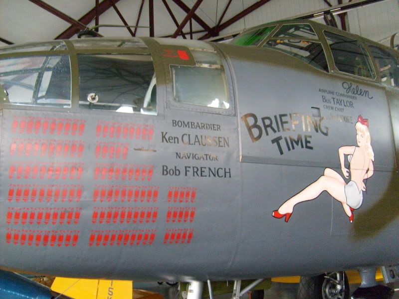

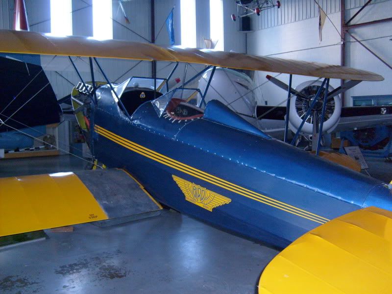

My camera battery died so I did not get too many pictures of the rest of the museum, but they did have a pair of recent additions, a very nice Culver Cadet and the great little blue and yellow bi-plane pictured below.

the 2800 is getting hung cause it's heavier then a 55 gal drum

Sorry Mudge, I meant to say that they will be hanging the big round thing that sometimes makes smoke and noise and spins the prop... :lol:

Actually, a 55 Gal. drum full of cement will come in around 1100 lbs. We used them @ BADWRENCH (and they probably still do) as ballast on 727's while in maintenance and especially when they are on jacks. I've actually weighed 727-200 freighters where the nose scale read 35 lbs. (had one for a certain brown and white operator that came in @ ZERO lbs. on the nose jack, so we had to add a second barrel to get a number to work from) using the foreward body jackpad with a cement filled barrel attached @ sta. 350 on the jackpad. As part of our quality audit program we would weigh each ballast barrel with a dynamometer and paint the accurate weight on each barrel twice a year with a paint pen.
Using sta 285 (jackball on a 727 nose gear) X 35 lbs. gives an arm of 9975 which is added together with the weights X arms of the mains ( and those moments can and do reach high seven or eight digits) to give the total moment divided by the total weight and a manufacturers provided divisor formula realizes the % of MAC, and on a 727, as long as it's around 41% of MAC (mean aerodynamic chord since all weights are positive to Datum) your empty weight and balance is in range, a standard desk 10 key wasn't capable of doing one of the division problems but I had a really cheap bank gift pocket calculator that would do that particular quotient. The standard is three weighs, moving the load cell to the next location for each weigh, add up all the weights and all the moments (the arms stay the same because the are constants) take the total weight and divide it into the total moment using the moments(REALLY BIG number!)for your averaged weight of the empty aircraft). Had one 727 where the weight kept drifting on the scales, someone pointed and said 'why is 'he' inside?' Seems some blanket bunny got missed when the tube was closed up and he was walking back and forth inside the cabin while we were trying to weigh.
So a barrel full of water laid on the engine lord mount should be more than enough to keep the nose on the ground. Drain the water and the barrel is easily removed or installed then fill it through one of the bungs.

Makes my little heart go pitter pat.
It's a Brunner Winkle Bird. This one is unique because it's the only one left with a Tank engine (think air cooled OX-5, not armored military vehicle.)
Great pix of the P-61. Thanks for posting!
