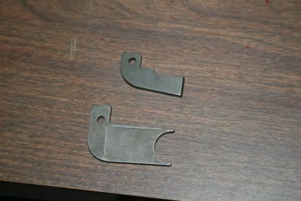

Could I please get some assistance. We were recently cleaning up some of my Grandfather's tools and came across a bucket identified as "P-51B." Most pieces were small rivets, nuts, and bolts, but there were a couple of items we didn't recognize.
One piece about 2 inches long by one inch in width reads, "A-13541-16k"
The other piece reads, "Rear right hand." C-77408-9. It's roughly two inches by two inches and has been machined.
Thanks, Julie

Below is a link with photos. (I took them before reading tips from The Inspector). I placed a quarter next to the parts so you can determine the size.
Please let me know if you can id the parts. Thanks, j

I am confident that both those parts are from a .50 caliber machine gun. They would not be exclusive to the P-51B however and could be found on nearly every WW2 vintage combat aircraft.
Here's one of those pieces from a semi-auto .50 cal I built up some years ago:
And I think you'll be able to see part of the other piece on the side of the gun:

I concur with BDK. These parts are feed way parts for the Browning ANM2 50 cal machine gun. They were used on all M2 50 cal guns both ground and air so it may have come out of a P-51B but it is a common part for guns used in all aircraft during and after the war.

As the others have said, both are parts of a .50 cal M2.
A-13541: Stripper, Link
C-77408: Stop, Cartridge (R. H. Rear)
Good clear exploded diagram and parts list HERE.

Wow, great work guys. Thank you very much!
