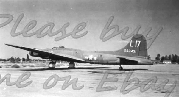

On page 109 of William T. Larkins' book Surplus WWII U.S. Aircraft there's a photo of a Navy P2B-2S (B-29) taken at Van Nuys, CA in August of 1949. In the right background of the photo is a B-17F showing the tail number "290431" - but 42-90431 is a BT-13B serial. It also carries a training field code of "L 17" on the fin and below the cockpit windows. Props and accessory cowls are missing. Anyone have info on this one?
Paging Mr. Larkins (and aerovin2 while I'm at it)...

I don't have anything to add except that it's not a mis-paint of 230431 as some have suggested.
3 June - A B-17F-100-BO Flying Fortress, 42-30431, flown by Ira R. Johnston of the 90th Ferry Squadron, 7th Ferry Group, flying to Grand Island, Nebraska from Pendleton Army Air Base in Oregon crashed on Bomber Mountain in the Big Horn Mountains of Wyoming. 10 crew members were killed.

Is it just me, or is there something weird about the engine cowlings? They look almost undersized, and with no curved "lip" on the leading edges. I know early B-17s had a separate cowl ring, but I believe they went with a three-segment design starting with the E-model.

No cowl flaps or belly turrets and the belly looks rough, probably wheeled up. Can't explain that number though.

Possible movie prop?

My guess is it was used as some form of ground training simulator.
Previous accident damage could lend it to this type of use.
Van Nuys might have been a repair depot/pilot or crew training facility of some sort IIRC.
If the engines had to be run for extended periods of time then the modified cowl set up would allow that without over temps on the cylinders.
I've seen various setups for fighters where P-38s and Mustangs are bolted in place or suspended in concrete blocks to allow a simulated T-O, gear retract, engine start, ect.
Wonder if this was used in a similar fashion.
I could see a belly landing repair or post ferry flight but the cowlings really don't make sense.

If the B-29 in the foreground is a Navy plane, perhaps the B-17 is, too? Maybe the number is a Navy Bureau number?

That airplane is likely one of the faceless, nameless crew or gunnery trainers that populated 2nd and 3rd Air Force stations right up to the end of the war. The "L" code possibly denotes assignment to Laredo AAF, either for the gunnery school or in support of the later B-29/B-32 training programs. I have no idea about the incorrect serial number, but it's possible that it is a "typo" done when the airplane was repainted. Perhaps after the takeoff incident that Tony has posted the airplane was refurbished and the wrong number was applied.....

The aerials underneath the tail are intact and the Football is missing which looks like the mains collapsed with the tailgear extended.That serial is a repaint and somebody got it wrong.The bars on the stars look added to me so maybe she is an early F.A new mission in trying to find out this ones I.D.

Here is another photo of the Mystery B-17 for what is worth.
If it is 42-30431 it was sent to several AAF technical schools before being sent to the 423BS/306BG at Thurleigh in Oct 1943. With this in mind and the ball turret being removed maybe it was one of the first H2X radar ships?
It return to the U.S. 21 June 1944 and then was sent to the Ford run engine mechanic school at Willow Run. Then it was sent as surplus to RFC Altus 29 Oct 1945.
It has been repainted since they are no Eight AF code letters and the radio call number has been relocated lower on the tail for the field number. The field letter L was not used for the gunnery trainers at Laredo AAF but a three digit number on the nose and tail or near the tail on the B-24s on the base. The RP-63s “Pinball” frangible bullet ‘target’ trainers used a infix field letter L i.e. 1L87
Since it was flown to Van Nuys, CA maybe someone might have the civilian registration number and a AAF serial number since they were few civilian B-17Fs.
