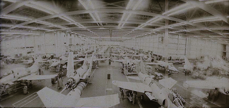

Something like this? I did a quick import into GIMP - which is a free open-source program, left clicked to the "Colors" menu, did "invert," and then tweaked it just a bit with "Curves."
And yes, I'm bored today with no students at the airport...
Ryan

Thank you Ryan, I'll give it try..............

Posts: 4528

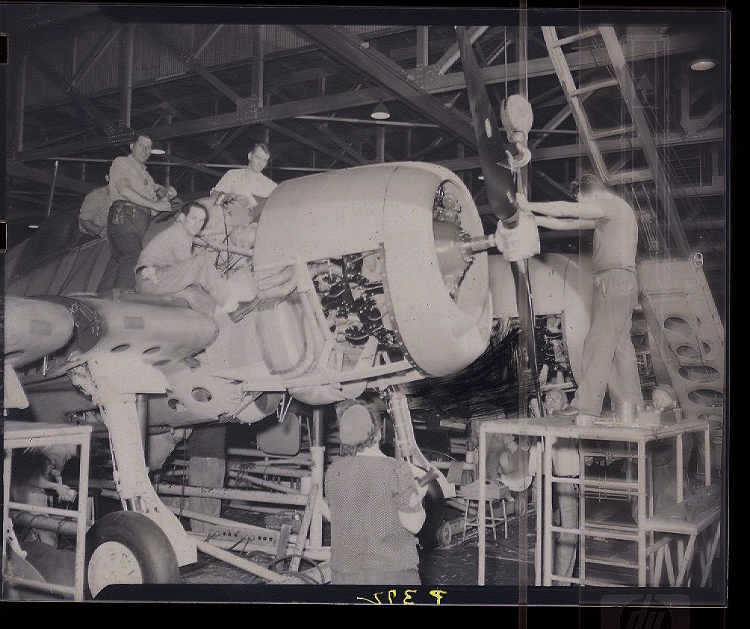

The quality on the second one isn't as good.
Ryan

How's that ?
IRFAN view (free software); effects, negative, color corrections, sharpen (which I overdid a bit).

Posts: 2348
Not sure what pitch the prop is in for installation, but the photo might be backwards.
PostPosted: Thu May 26, 2011 4:38 pm
Posts: 833
I think it is backwards, and thanks everyone.........

When I first looked at that pic of the Hellcat, I thought "wait, that left landing gear is on backwards!" Then I realized it belongs to the next plane in line, and the left gear is blocked by the "Rosie" in the foreground.
