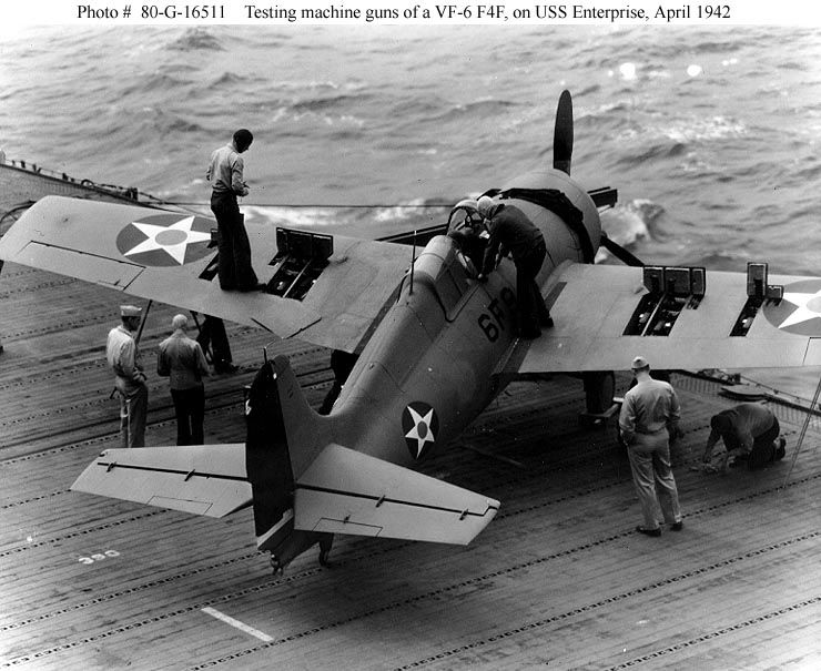

 Post subject: Re: Convergence of fire
PostPosted: Fri May 27, 2011 2:50 pm
Joined: Tue Nov 06, 2007 5:34 pm
Posts: 187
Location: NW Mississippi
Like this.
The caption said to plug your ears.
I'm sure Jack can find a better one.
