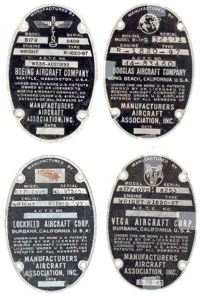

Have a question for all the B-17 experts out there. We need dataplates for our B-17 Champaign Lady - 44-85813. Below are modern repro's that are available - but which version is correct for a late model Vega built B-17?

From Dik Shepherd, who knows data plates, this bit of information:
Notice that the figures on the Boeing plate are a particular [machine] stamping, while the others are [obviously] hand stamped. This style for the Boeing data plates was started in the 1930s and is the same as on my Y1B-17 plate. Also notice that the Boeing and Vega plates don't have the USAAF serial number, while the Douglas and Lockheed plates do.
I doubt that you'll notice, but the Lockheed plate is from "HANG THE EXPENSE IV".
Tell the guy that his Lockheed plate would be correct.
I'll add my two cents that the Vega plate illustrated has the msn for the serial and it would be interesting to know if all Vega B-17 plates used the msn for the serial on the plate. I know the EAA airplane (44-85740) is missing its aft bulkhead plate...but there are a number of same block Vega-built B-17s out there (Yankee Lady, 390th Memorial Museum, Liberty Belle) that might have plates that will provide the definitive answer. Somewhere near the end of Pete Bowers' Fortress in the Sky is an illustration with several data plates. Not in front of me right now but perhaps that would shed some additonal light.

PostPosted: Wed May 04, 2011 12:06 pm
Posts: 842
Location: Pittsburgh, PA
The book entitled " Fortress in the Sky" by Peter Bowers, pg 246 has a photo display of the name plates utilized by the three mfgr's. The "Vega" plate pictured has data stamped for a B-17F (s/n 6253) and the Lockheed plate has the data for a B-17G-20-VE 42-97560. Bowers comments that the Lockeed plate was used after Vega became a division of the parent company. But then the question remains did Lockheed used up all the stock of the Vega plates prior to those reflecting the parent company? I would surmise that if you are applying the plate to a B-17G s/n 42-97560 or later you would be historically correct.
PostPosted: Wed May 04, 2011 1:13 pm
Joined: Tue Dec 30, 2008 7:10 pm
Posts: 125
Location: Ohio
Good information, I believe the consensus is a very late model "G" would have the Lockheed plate. We are going to try and make our own using a PCB (acid etch) process. We have made the rear data plate using Press-and-Peel PCB paper and a laser printer. This is mounted on the bulkhead behind the rear crew entry door using - will post photo later.

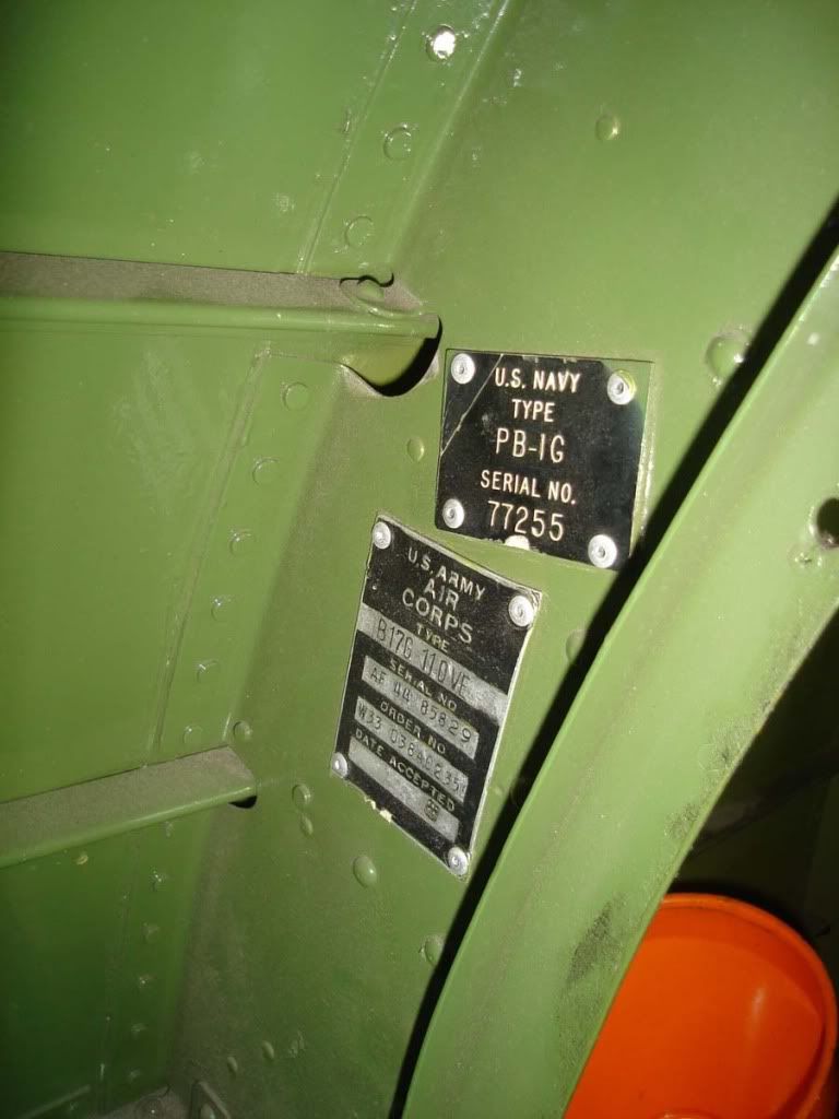

Scott,
This oval data plate was mounted on the lower lefthand corner of the instrument panel in front of the pilot.
The original oval manufacturer's data plate was missing from B-17G-110-VE 44-85829 when she was purchased by the Yankee Air Force way back in 1986. I remember having to make the same decision regarding whether to use a reproduction Vega or Lockheed plate almost 20 years ago. We used the one that says Lockheed.
What we believe to be the original "U.S. Army Air Corps" data plate is still in the aircraft back by the tailwheel on the right side of the fuselage. There is a plastic U.S. Navy/USCG plate next to it.

PostPosted: Wed May 04, 2011 5:57 pm
Posts: 863
Location: Lincoln, California
Not directly applicable to the original query, but nonetheless interesting, these are the data plates affixed to the bulkhead just aft of the maiin entrance door on B-17G 44-85829 (or PB-1G 77255), otherwise flying now as N3193G, Yankee Lady, courtesy of Todd Hackbarth.
