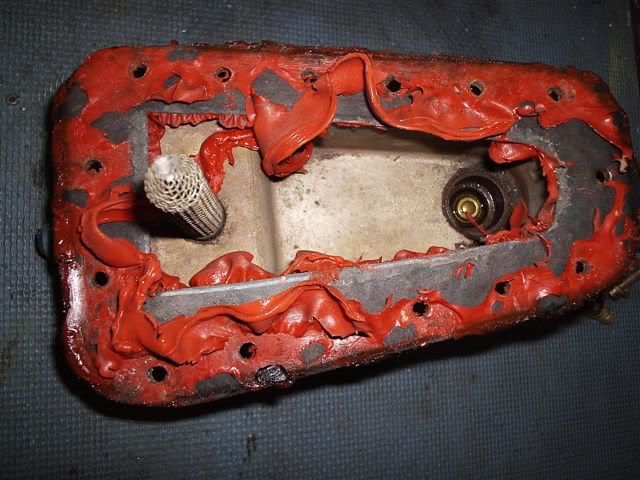

I noticed something red and fuzzy coming out of one of the drains when I sumped the fuel tank prior to flying. In the course of having other "get around to its" done during Winter Maintenance for Moosejaw Belle I asked Randy Wahlberg to have a peek at the fuel tank.
BOTH tanks had gaskets on their sump panels. But the previous owner wanted to make sure they were good and sealed so he used this.
Red RTV might be good for some things, but two things it isn't good for: Being subjected to AV/Gas or anything else on an aviation engine.
I just thank the Lord the engine didn't suck up enough of that to quit in flight.

ANY RTV has no business anywhere near gasoline as you can see the results for yer self. COPPERCOAT or FORMAGASKET and fairly stout nylon string run around the mating surfaces inside the bolt pattern holes ( parallel over lap the ends) so the string is trapped and compressed by the mating surfaces will give a forever, leakproof gasketing application that's easily removable. Old motorcycle riders tip from an old motorcycle rider!

I pulled the scavenge screen on a Continental 670 awhile ago that had been zero-timed and then run in the test stand for five hours, and was rewarded with a handful of clear silicone schrapnel. I was less than impressed. :|

What both spooks me and ANNOYS the living crepes put of me is the thought of all the people I've stuck in the backseat and given rides to over the last year.
This shoddy work could have taken out not just the aeroplane and myself, but radio personalities, friends and loved ones, Volunteers at the CAF that I was giving atta-boy rides to.
