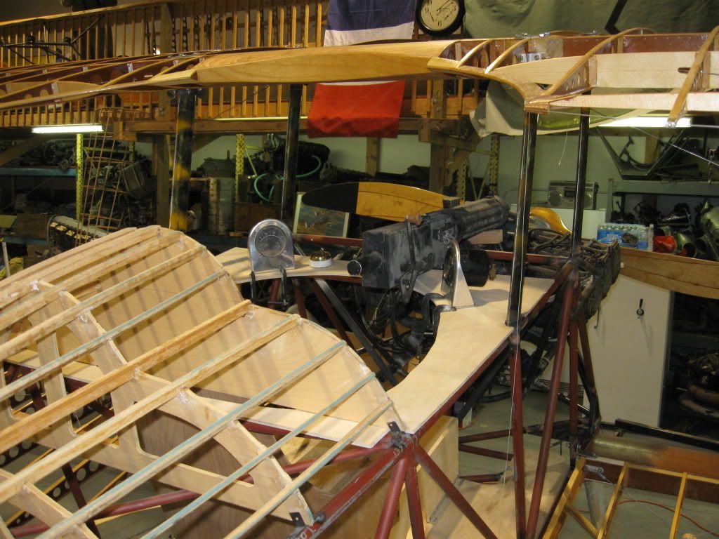

I just spent a week in Colorado at the Vintage Aero Flying Museum http://www.vafm.org (also on Facebook) , just north of Denver, helping them work on thier replica SPAD XIII, and thought I'd post some photos. We had authentic style wings to mate to a steel tube fuselage, which took a little engineering, but by the end of the week we had it all together.

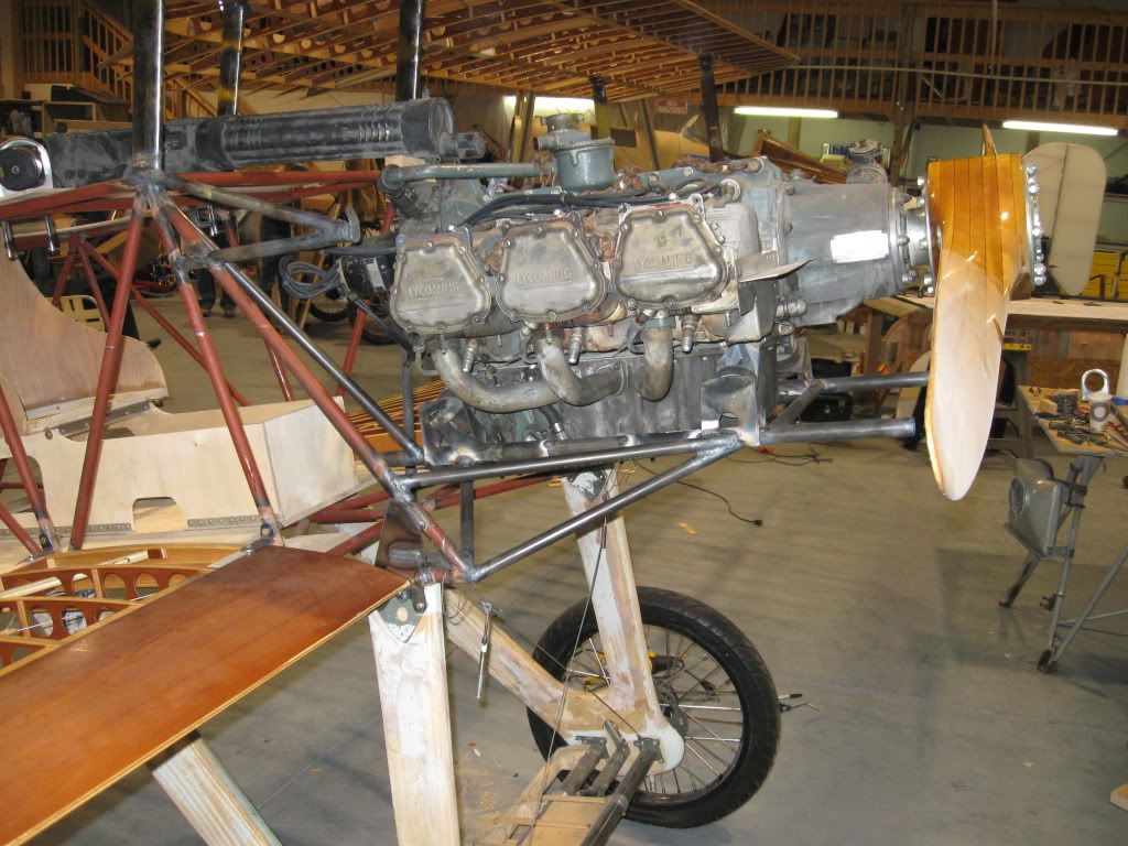

Engine is a Lycoming GO-480 which actually puts out a bit less lb-ft of torque compared to the original Hispano Suiza, but it will be plenty. The aircraft is being sponsored mostly by the family of James Norman Hall, author of "Mutiny on the Bounty", and WW1 fighter pilot, although as these things often go it's a bit over budget, so donations to the museum to help finish it are always welcome. Here is a photo of Hall with a SPAD probably taken at about the time he scored his 2nd and 3rd victories on March 27, 1918:

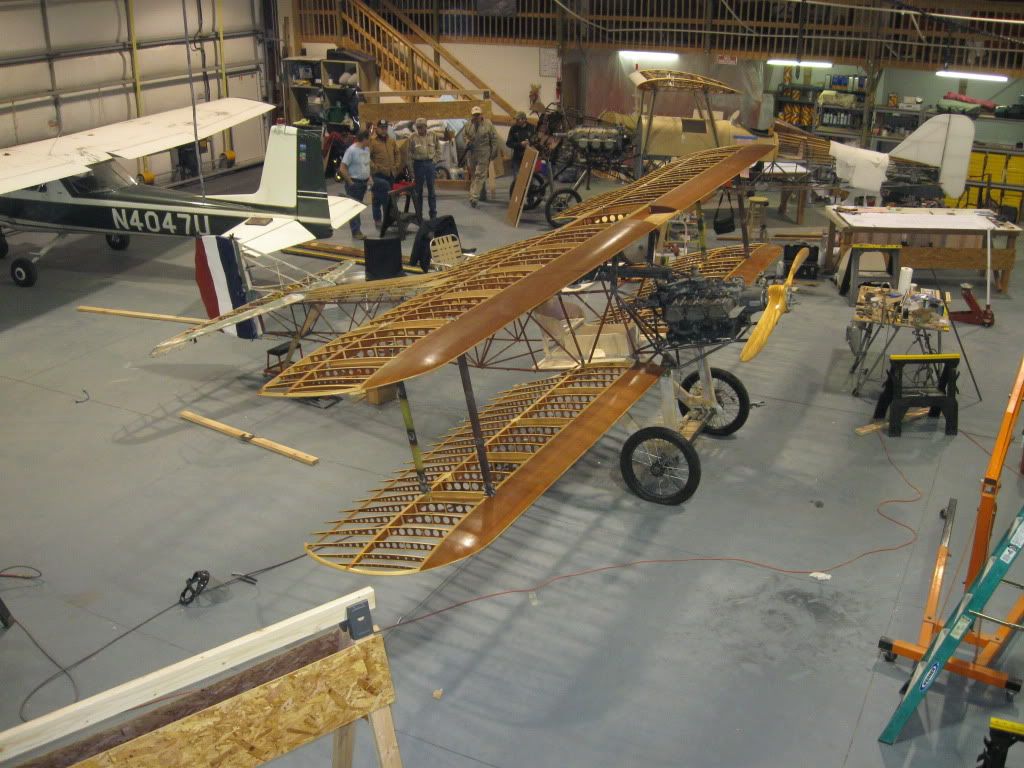

What is the old airplane in the background. Something original or another replica? Inquiring minds need to know!
Kevin McCartney
PostPosted: Wed Mar 09, 2011 10:45 am
Are you referring to the SE- 5A replica or the semi rare 1965 CESSNA straight tail 150? That style 150 is sort of a collectors item, they didn't build the square tail with cut down fuselage very long.

That is an SE-5a replica behind the SPAD, which will also get a flat six engine of some kind, and behind that is a replica Sopwith Camel. Both of them are not that far from being ready to cover, but the SPAD is on the front burner right now. The hope is to fly it this year. The VAFM fly-in is May 21, and all three Fokkers should be flying then.

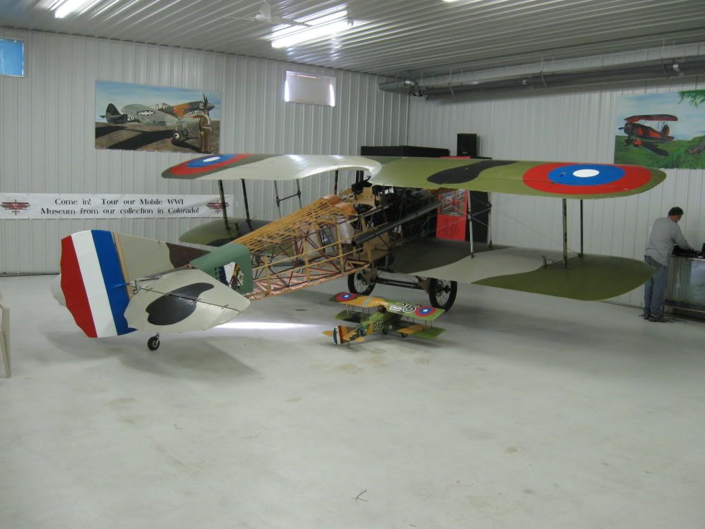

Spent another week in Colorado and here are some photos of the SPAD progress
Andy Parks has been doing most of the doping, brushed on like the old days. I helped out when I wasn't welding stuff on the fuselage. WW1 French airplanes in 1918 used a five color camoflage scheme on upper surfaces (dark and light green, beige, brown, and black), with cream colored lower surfaces, and the French mixed aluminum powder into the dope (except the black) in the apparent thought that the increased reflectivity would help the camo effect. We experimented and found that 4 teaspoons of silver paste mixed into a gallon of thinned (1:1) dope produced a peculiar sheen that pretty well matched original fabric samples in the collection of the museum. Two brush coats of each color (three of the black) were used. Andy tried to use standard Randolph dope colors, the topside beige is a little light, and he ended up having to custom mix the light green (8 parts lemon yellow to 1 part black), but the end result looks good. The silver powder wasn't mixed into the paint used on cowlings and access panels, accounting for the different colors on the fuel tank cover in the center of the upper wing.
