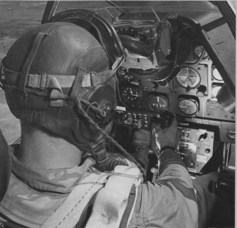

N-9 with B2 adjustable sighting head. Had always heard it was used on the Mustang but never saw any reference of it in any manual or period photo until i found this one (and only one) last week. It's from an ANG plane in 1947. Does anybody have additional period photos of P-51 with B2 head ?

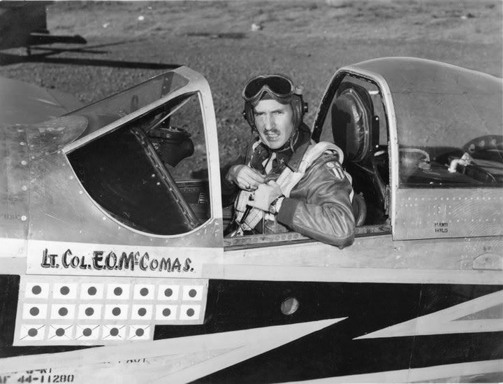

Mark 8 mod 8 (or 5) gunsight. Standard Navy gunsight commonly used on P-47D but a very rare fit on P-51D. Only been able so far to find one period photo (source National Archives).

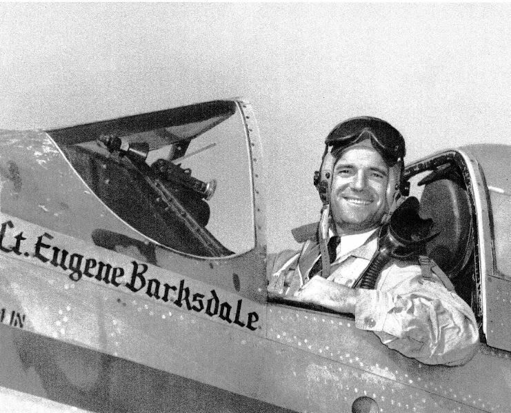

Lynn L-3. Standard P-38 and P-61 gunsight very rarely fitted to P-51D. Source : Jack Cook (i hope he'll forgive me to have saved one of his thousands of photos he posted on WIX).

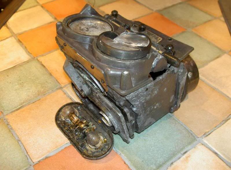

Mark 18 & 21 gunsights. Navy gyro gunsights only used in turrets in WWII. Always read it was fitted to Mustangs but has never found any info in manuals or any period photo of it. Can you help ? Only thing i found is this : photo of what is clearly a Mark 18 sight found during the dig of a 361 FG P-51B that crashed in June 45. Source : EAST ANGLIAN AIRCRAFT RESEARCH GROUP website
