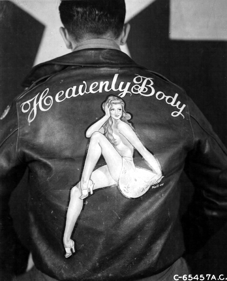

Matt, thanks for the reply- I'm familiar with Apple Barrel paints, I've been toying with whether to go with those or Model Master enamels. Sounds like the Apple Barrel stuff will do just great for my purposes, so I'll recommend them to my friend. (He's a fantastic artist, but hasn't done a jacket yet)
As far as the comments about what people wear on their jackets, here's the short version of the story; I had a relative, Lt. Frederic Ritger, who flew 68 missions in the 446th BS/321st BG. On one of those missions, he was command pilot of a plane named "The Little Admiral" and his turret gunner/engineer was SSgt James Utz. Ritger is my last name, and Utz is my wife's maiden name... neither is terribly common, and to have Ritger and Utz on the same plane on the same mission is just an incredible coincidence. So, to commemorate his service, and my family connection, I'm having a friend paint a Vargas girl on the back with "The Little Admiral" name above, and 68 small bomb markers below... I've already got a 446th BS patch on the front of it, and at some point want to get the "old style" XII Air Force patch for the left shoulder.
Here's the inspiration I'm using for the back- it's easily one of the most amazing jacket pieces I've ever seen.
