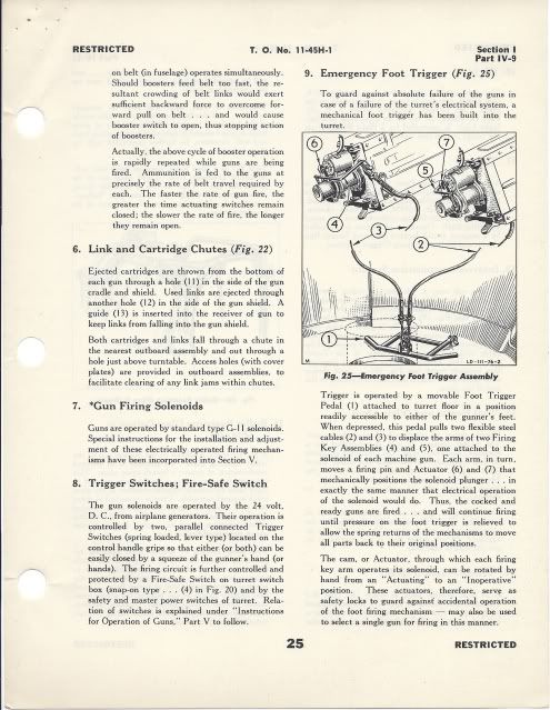

PostPosted: Tue May 31, 2011 5:06 pm
Posts: 895
Location: St. Louis, Missouri
Ron,
This is the Operations and Service manual for the tail turret version of the A-15 so it is a bit short on details for some parts of the turret. I'm just lucky that Gary Norville acquired this copy from a fellow WIXer. I suspect that both a Parts manual and an Overhaul manual were produced but I've never seen a copy of either one. Here are the only two pages that I found where the link chute and spent case chute are mentioned. I'll keep you posted if I find any more information.
