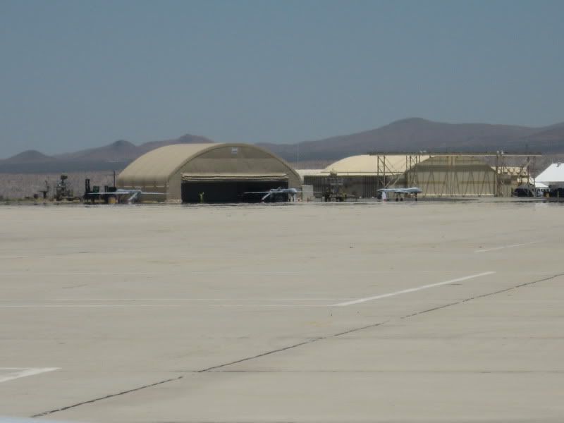

I am asking this in the main section as I would assume that most of them would be military. Do any of you guys fly at an airport that has UAV operations? There is conversation about UAV's coming into our airport. I am wondering how this will work with other traffic. Does the tower talk with the operator?

We were test flying a modified Hawker 800XP in Victorville, CA last summer and had to deal with these in the pattern.

USAF UAVs operate with a local control van and a ground support team that is actually on location. Once the aircraft is out of the airport traffic area, they hand over operations to one of the centralized control locations (Creech AFB, Cannon AFB, etc).
So, airport controllers will talk via VHF/UHF to a pilot who is physically located somewhere there locally.
When it's being controlled from much further away, the radio comms are with that operator, but relayed through the satellite link on the UAV itself such that it's coming from the antennas on the aircraft.

OK, sounds like I would just work them like any other type of aircraft right? Can they take instructions like hold short and such?

yes. They have a local controller/handler eyeballing on the ground.

Thanks guys. If this happens I will be sure to get some pics.

a week ago, I watched a UAV practicing landings at Victorville, along with a Mooney flying next to it. Never seen that before.

I've flown with both civilian and military UAV's (civilian at LRU) in the pattern. My first experience was back in 2003, I once had to wait for 15 minutes on the ground while a Predator took it's sweet-ass time on an approach into a base in Kuwait. In more recent times, the UAV, operated by CBP, was almost normal traffic.
In LRU, the local college was operating UAV's, and had a CT Designs chase plane. That was the first I had seen that. Since this was a non-towered field, others in the pattern gladly made way for them to depart.

UAVs act like normal traffic, to include the radio chatter. Someone who didn't see the airplane, but heard the comms, would never suspect a UAV was mixed in. Enroute they typically squawk, so TCAS/TIS, etc should display them.
My complaint, although mission oriented, is that they seemed unable or unwilling to move from their preprogrammed orbits, forcing the manned airplanes to make large heading or altitude changes to accommodate them. Sometimes I realize this was necessary, but sometimes I think it was willfull inflexibility. My other beef was that ATC would block large working areas for them and not allow us to cut through any of it, even though the UAV was clearly on the other end of the airspace and at a speed that would prevent a conflict ... even if he pointed straight at us. Although that occurred in the AOR, I can see a UAV in a "police orbit" (or equivalent) causing a similar issue stateside.

I agree, our experience in Victorville was the airplanes with real people in the cockpit had to wait on the UAVs. In fact our FAA test pilot commented that this experience was the first time he had to hold short for an R/C airplane.
