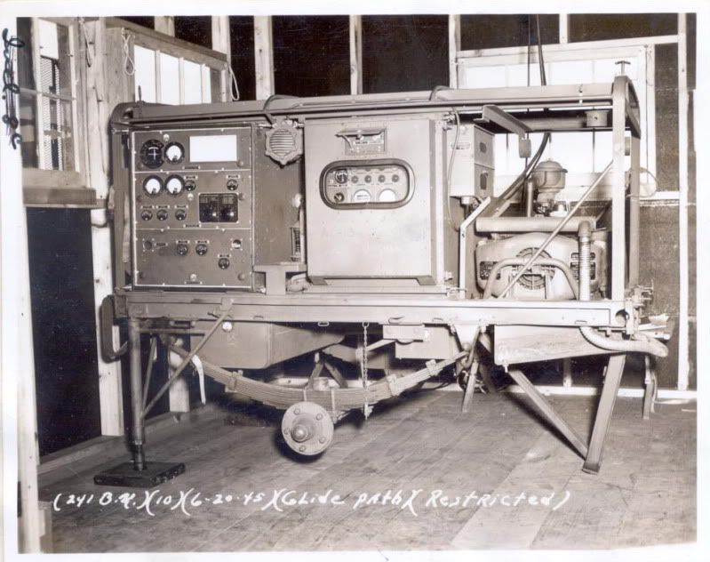

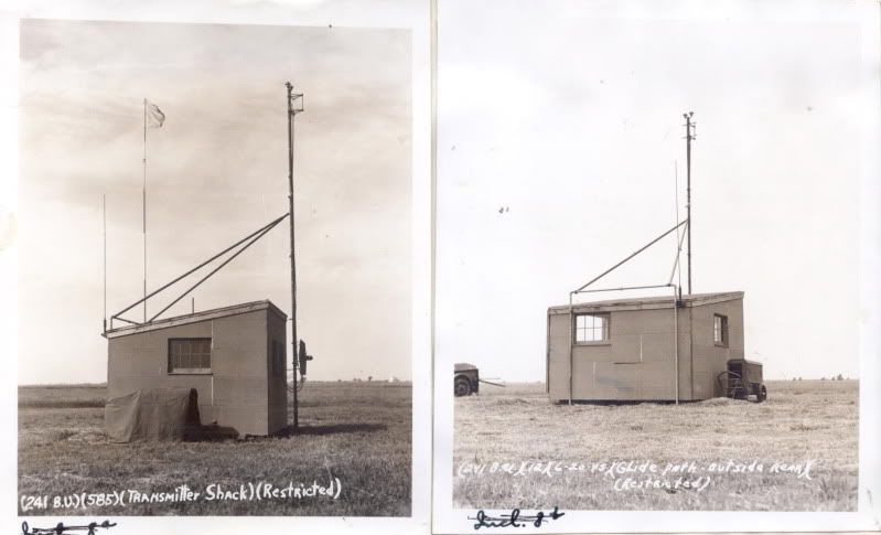

Here are a couple of photos of the ground installation of the Glide Path System that was installed at Fairmont Army Air Field. This system was installed during the B-29 Phase Training effort. First is two views of the shack and antenna array:
And this is the equipment installed in the shack:
Scott

Second Air Force wrote:
There is a nice article on the SCS-51 system here: http://www.flightglobal.com/pdfarchive/ ... 02170.html
Scott

That wheel hub on the radio trailer looks like a great shin killer for the unwary.

Imagine how loud that shack got with the putt-putt running! OSHA would not be impressed with 1940's ingenuity. Also, notice that there is what looks like a larger generator set parked next to the shack. I'm wondering if the transmitter wasn't powered by the external unit and the trailer mounted one was used as a backup.
There was an interesting incident that involved this glide slope transmitter. A 16th Bomb Group B-29B, 42-63613, got off the localizer and hit a good sized tree during an approach. They got the airplane down safely (off-field landing) without further damage, but the tree tore her up pretty good. I've got several photos of the damage somewhere and the incident report.

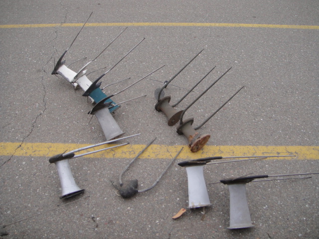

For what it is worth the system used in WWII is still operable today in that it was a VHF system that used two receivers one for a localizer and one for glide path. The frequencies used for glide path then are about the same today. Back then you would select seperate You can use the original WWII antenna system for VOR and Glideslope with modern radios. In the antenna on the B-17 pictured above the aft pointing U shape is for localizer and can be used for VOR and the two lateral ones are for the glide slope. From what I understand (no supporting documentation to prove it) there was a blanking issue with the early straight back localizer antenna so they bent the rods slightly outboard for better reception.
The first systems seemed to have separate antennas for glide slope and localizer. The next had the one that was pictured above on the B-17 and then the latest style had the angled localizer rods.
Here is a crude inventory photo of the the antennas in our collection. You can see the early OD green ones without the glide slope on the front. Its hard to see but behind the green antennas is a stand alone glide slope antenna that was used in conjunction with the green one if needed. The three silver antennas across the bottom are the combined antennas with the one on the lower left being an early example. Sorry I don't have the antenna designations handy. As I recall one of the later war/just post war systems was AS-27/ARN-5 but don't quote me. In the upper left is the mostly post war antenna that has the angled localizer/VOR rods.
