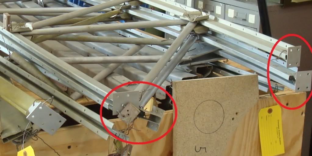

The top pic kinda looks like the brackets that hold the trailing edge ribs to the aft wing spare.

cptsmith wrote:The top pic kinda looks like the brackets that hold the trailing edge ribs to the aft wing spare.
Their are similar brackets that hold the rib in place between the front and rear spar as well. I enlarged and circled them in an image I took at Urbana. Next time I`m there I`ll have to take some better pics of this and post them.

Wow- good eye there! I think you are on to something. We also found, in the same location, some of the corrugated aluminum that is sandwiched between the spars and the inner wing, so your ID is probably spot-on. Thanks!
This crash is near the Sioux City, IA Airbase. There are many more like it here, this one just happened to be on my family's farm.
I will try to post some better pics soon to help with the ID of some of these other pieces.

If there were corrugated skins nearby, 17f probably has the right location. The trailing edge has no corrugation, just a thin over some light ribs.
