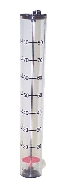

I remember when I was hanging around an ultralight field back in the early 80s, most had these plastic tube type airspeed indicators. Of course the materials were modern, but I suppose the basic design could go back quite awhile.
