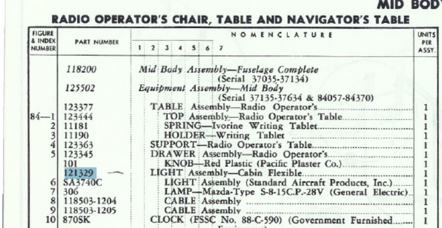

Once again, I need the assistance of the warbird community experts. I bought the aircraft lamp (photos attached) with the plan to make a desk lamp from the neck and light housing… but making lamps from pistons (flyingcircleh.com) looses some of the “cool factor” if I can’t identify the parts.
This thing has me stumped. The only ID on it is the rubber stamped number 121329 and the cast in number SA-1370-A (logo) on the bottom of the box. Top of the box has a “proper” military paint job, with the “ON OFF” cleaned off with a thumb.
I would like to know what the logo is also. Looks like 2 back to back “D”s, a “C” and the abbreviated “Co.” Could the “OK TO V CLOSE” be a clue to the year?
The brass gooseneck is stamped with FARIE MFG CO. which I know was an old lamp making firm in Decatur IL.
I’m thinking aircraft because it has a 28 volt, 2 contact, bayonet type bulb (GE Mazda). It’s all non-mag, ie: aluminum, brass, stainless. The box holds a ceramic rheostat with OHMITE CHICAGO on it. Correct Bakelite knob for WWII era controls.

The OK TO CLOSE with the letter and number would be the 'bug number' assigned by the manufacturer to a specific Inspector in their facility to make it traceable back to that individual in case of malfunctions.

This lamp sure looks like the one shown here in Taigh's PV-2D thread below. Installed in the radio operator's position.
http://warbirdinformationexchange.org/phpBB3/viewtopic.php?f=3&t=38160&start=435#p442799
The V on the inspector's stamp probably stands for Vega aircraft
Check out link below to the Lockheed section of inspector's stamps to see a similar V stamp
http://www.aviationarchaeology.com/src/astamps.htm#LOCK

Dewayne is spot on. That is not only the correct type used in the Harpoon but it even has the Lockheed Vega inspectors stamp and part number.
Any chance I could trade you another lamp for it and put the Lockheed approved one in the Harpoon? The PV-2 carried two of these lamps. The other one goes back at the tunnel gunners station.
