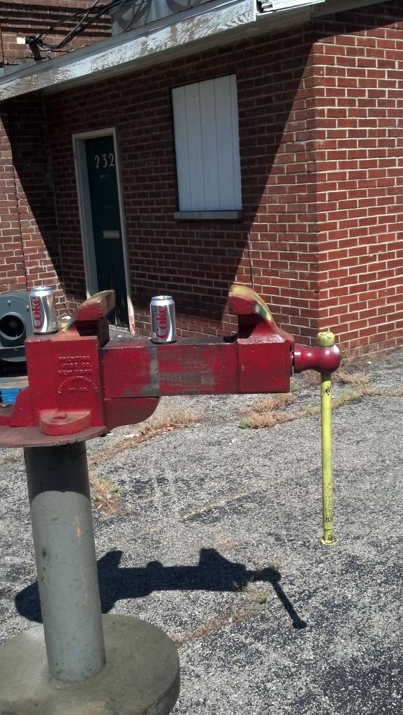

On another forum we use a "UMD" for scale, The Universal Measuring Device, aka, a soda can :) like this...
