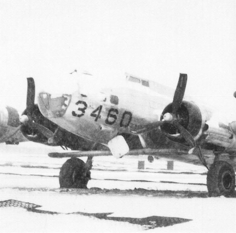

How did propellers blades get bent without wiping out the AN/APQ-7 Eagle radar or the nose?
Aviation Archaeology has this B-17G-80-DL 44-83460 assigned to the 64th AAF BU (Andrews Field) (H.Q. Continental Air Forces) with category 4 damage from a landing accident at Patterson Field, Ohio on October 21, 1945 where the photo is taken.
What do you all think?

Tom, it looks like the wing is not sitting square with the fuselage anymore, so possibly the supports failed and it is still hanging askew on the damaged struts. I have no better explanation unless the mains were partially extended and they helped support the airplane as it settled. The propellers aren't bent to the extent they usually are in a full-on bellyflop.

looks to me like the tips of the blades are bent forwards, so perhaps the aircraft was stationary (engines running) when the gear started to retract (brakes on), causing the aircraft to move backwards in relationship to the ground due to the swing geometry of the u/c? Could also explain the lack of heavy damage to the airframe.

Prop blades bent forward, are indicative of engines that were producing power at the time of the strike.
Correct.
My first guess was a go around when they realized the gear was not down. Just a guess though.
Absolutely. One of the 'what really happens, not what you think should happen' tests. ;) Very common when someone gets a bit low over the drink, although the report for this one indicates otherwise.

I suspect it is because the MLG wheels extend below the engine nacelles when fully retracted.
Or, perhaps the pilot realized his gear was up when the props hit on landing, and managed to get airborne and land again using the wheels instead of the props.
Had a twin Cessna do this recently. Pieces of prop blades cut through the cabin and caused some substantial damage.

Appling the power and pulling the plane up at the same time as the props are hitting the runway.

Arent the two outer engines higher up? They might not have been as severely damaged, if at all.
#1 prop looks to be OK....

Nope, no last minute go-around, just the left main landing gear motor burned out and the emergency hand crash torque tube broken (possibly from being turned the wrong way) so they elected to do a gear up landing.
