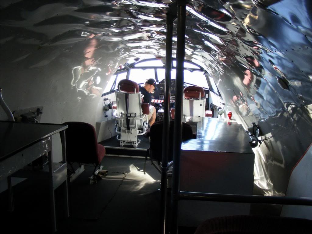

I recall hearing or reading somewhere that the FE on the MARS' position is some 35 feet aft of the flight deck. And in service wasn't the 'Engineer/Crew Chief 'on the 17 and 24 a side job for the top gunner?

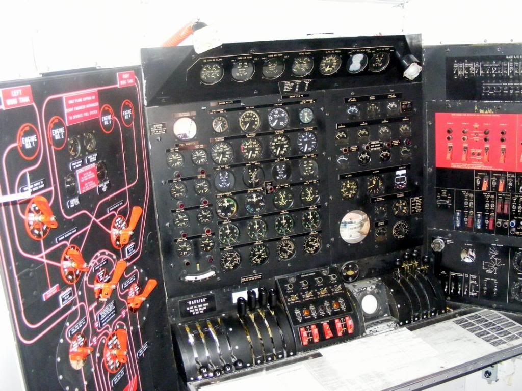

Some pics from the Philippine Mars in 2011.........
The FE's station.........
......and his view forward. Sorry, didn't measure it!

The only warbirds, flying, requiring an FE is the B-29, Mars, C-121, Lancaster, and hopefully in the near future, a C-97. These aircraft had an FE panel seperate from the pilots panel and had his own set of throttles except for the Lancaster.
