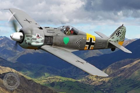

No there isn't, ours has been fine as have most of the others flying with them aside from one or two hiccups, the major one being the cause of the ditching of the French based example (since rectified). Problem was always with the cooling- but this has been sorted. Although IIRC cooling is still a problem with the Frasca 190 and the 2800.
Lots of teething troubles with these, but the Omaka based example is flying sweetly and has being doing so quite regularly.
Nearly all owner / operators are in regular contact to work through problems.
Dave
Gavin Conroy photo
