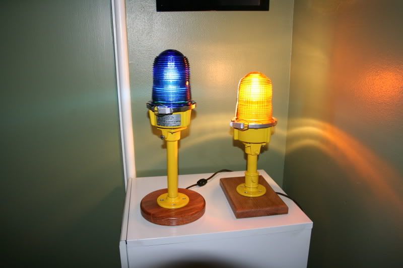

I take old runway lights and convert them to household current. I simply get the wire and sockets from Lowes and rewire them and put a standard bulb in. I am sure you could do the same thing with a correct size socket and bulb. You can keep the old wiring and socket in case you wanted to convert them back.

When the crews change out damaged runway lights I try to get the upper base if it is considered trashed. The stem and lower base I get from Tractor Supply and then I order new globes. The wiring, switch, plug and socket come from Lowes and I make the wooden bases out of mesquite wood.

me + pathfinder = success
