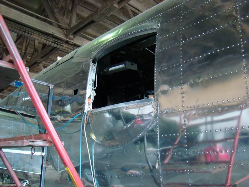

My father use to work for Terry Harrold (fellow who donated this Mitchell) back in the 1970's. The first photo is when it was still on Terry's farm back in 2000. Second photo is shortly after it arrived at the musuem. Third photo was taken last Summer (2009) and last photo is the repair of the side blister. Regarding Tom's comment on the side blister, the story is that the crew (owners) of B-25 "Silver Lady" which at one time Terry owned (purchased from Bob Diemart in Carmen, Manitoba) used a circular saw and cut it out for repairs they needed for their fuseluge.

Interesting photos! Looks like it was in real bad shape there for awhile.

Pat it really was a very solid airframe, but I understand she was the parts queen for their water bombing operation...so it wasn't so much bad shape as scavanged, other than that waist window...it was a tough fix.

Here's another view of how they cut the side blister from this Mitchell.
